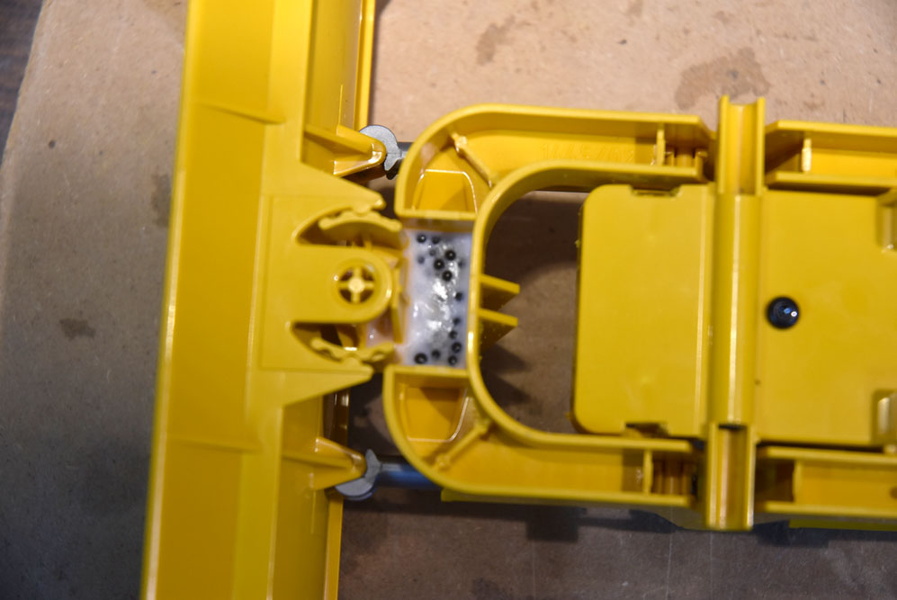

I noted above that the blade assembly of the D5 didn't weigh very much. Turned out that there was just enough resistance of the operating wire through the tight radius of the tube that gravity would not pull the blade back down. Ideally you always want to keep the wire of a bowden cable under tension. They work great for pulling not so good for pushing. And this tiny little cable really flexed when pushing even this light weight blade down. One soulution might have been to make the outer tube longer towards the servo attachment thus keeping the inner wire from being able to flex as much. Much easier to just add a little weight to the blade.
A little no 8 shot and some casting resin poured into a pocket on the underside of the front of the blade mount cured this issue. Didn't take much, only about a third of an ounce. Now the blade comes down on it's own when the cable is slacked.
