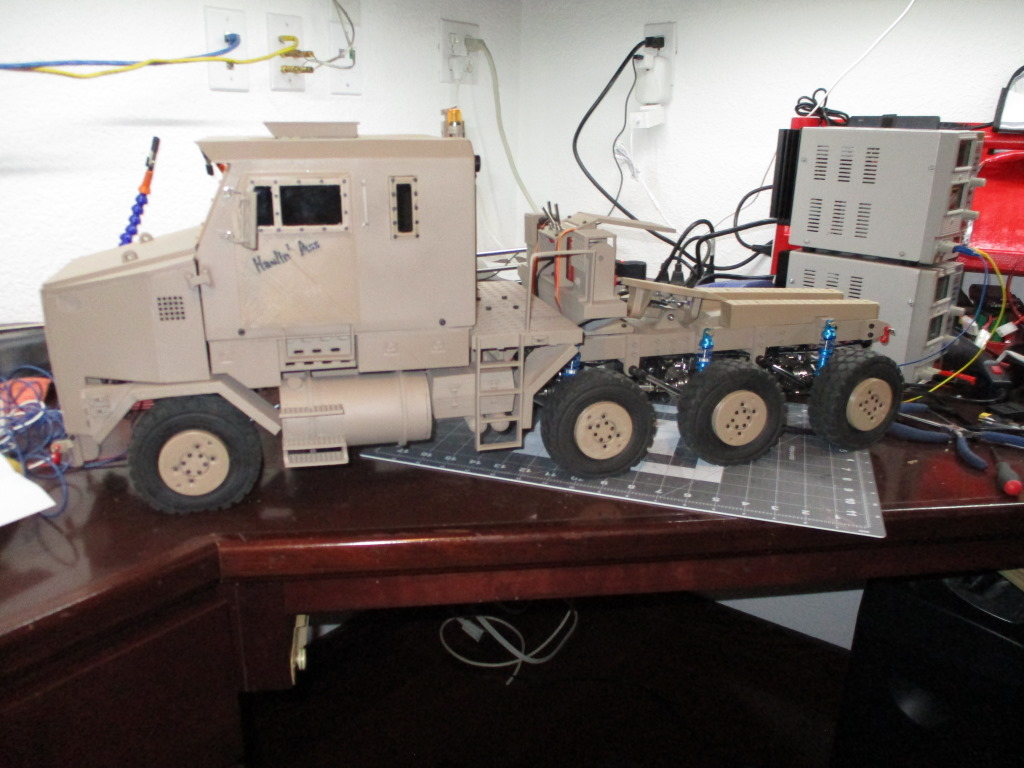

In any event, if you have an Abrams, it only makes sense to have a prime mover it for it too, right? I mean,
Well, like the Abrams, harder than you might think. Partially that's because the trailer has to cope with the tank being ridiculously heavy (over 50lbs.)
It's fairly close to the 1:1. I've seen a couple other builds here that are more accurate and better models, but favoring function over accuracy seems to be my thing. The truck will pull the trailer loaded with the tank, at least on flat terrain with good traction, so again, a qualified success.
The regulatory money shot, all six feet and, I dunno, 80 or 90 pounds of it:
Frame and drivetrain are basically the same as my previous HEMTT/PLS, save that this one is 8x8 instead of 10x10.
The cab also rides a lot higher on this one, so the hood hinge is waaay low. On the PLS, I had to hide the battery in the cab which is a pain to get to, have to undo screws. (We call this a "learning experience" ) For this one, the battery goes under the hood, coupla snaps, boom.
The cab is mostly sheet from the local plastic place, with square tube down the corners. It's done up as an armored cab, so the doors and windows have printed frames with tinted acrylic
The hood is 3D printed because it's stupid shaped, and to give detail like the grille, air intake, etc.
Bars are glued temporarily to keep the thing square.
Greebling is a mixture of printed and fabricated. Fuel tanks are ABS drain pipe, with printed rings and brackets to mount to the frame
Toolboxes and the platform behind the grille are printed.
Exhaust is just plastic tube and bar from Evergreen, with a printed heatshield. I don't have the patience to cut that many holes by hand!
Winches are, duh, winch servos, nice metal gear ones (learned my lesson about buying cheap ones when I built the forklift!) The drum-cable-hook setups are off-the-shelf Chinesium of matching spline count. The outer end sits in a brass tube which goes into the 3D-printed box. This gives the drums a nice double-shear mounting so they don't flex. An M4 bolt below the drum acts as a convenient stop for the hook. They have enough pull to load a truck in neutral up the trailer, but won't grab anything stuck, especially the Abrams.
They're set up on an Arduino. The TX has one up-off-down momentary switch to winch in/out, and another left-center-right to select either or both winches, so as to pull evenly if the load is off-center.
The controls are only vaguely representative of the 1:1; the switches aren't hooked to anything, but the light bar blinks when the winches are enabled. I do like me my blinky lights.

Coat of paint and some more detail work, and it looks mostly like an M1070:

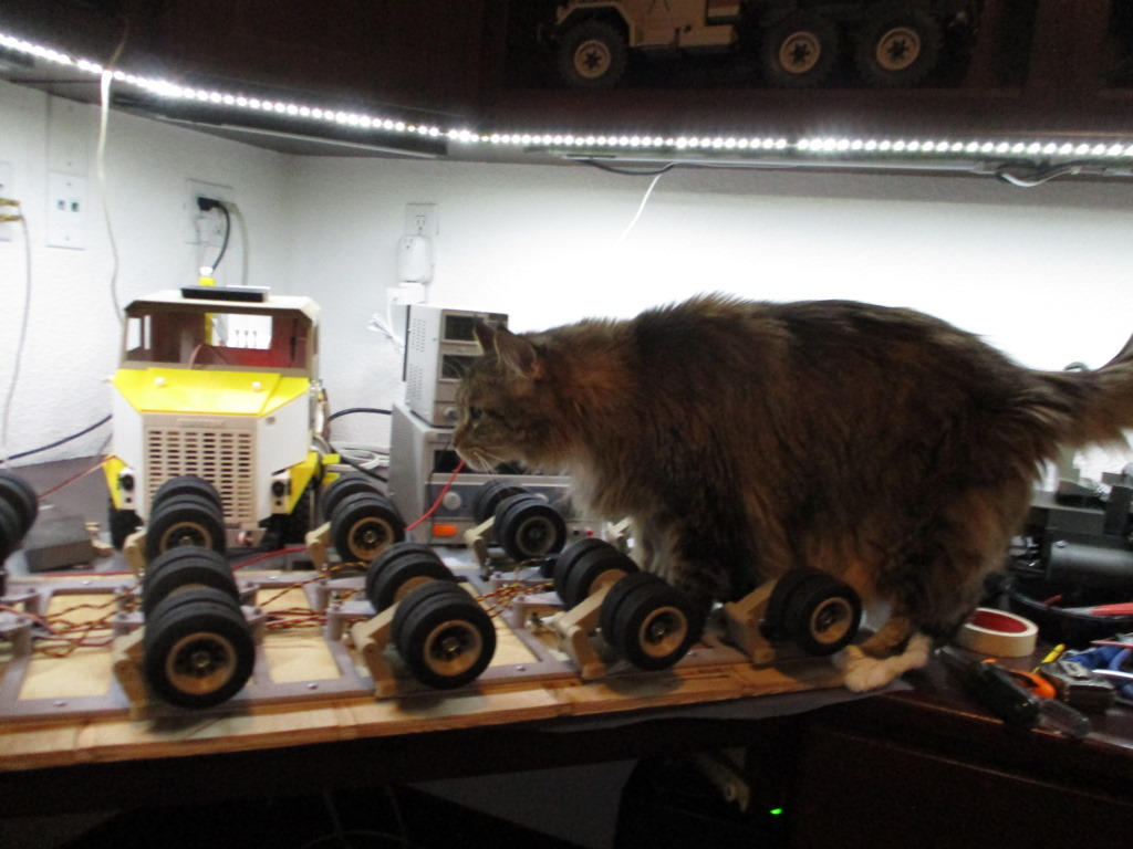

Five axle rows, with independent bogies each side, each bogie having four wheels. The really tricky part is that all of the bogies steer, but at varying angles. The fronts turn a little, the next ones back turn more, all the way to the rears turning a lot, and the outer ones turn a bit more than the inners. Here's a 1:1 in action
https://www.youtube.com/watch?v=f7jHBH_zrDs
No way I was gonna do that purely mechanically, especially when doing it electronically means that turning ratios can be changed at the push of a button. As always, draw the thing up first in CAD (donno what the red block is, musta been testing something)
Arduino (top), servo controller (middle), and a power distro board down by the big capacitor at the bottom. Had some issues getting enough current to run all the stuff (servos, lighting, outrigger legs), so there's a separate lager-gauge power wire in addition to the smaller trailer signal wire. The M1070 has matching plugs for both, but if it's being pulled by a smaller truck, a battery directly connects to the trailer power.
Also, that many servos create some serious spikes on the 6V side when turned quickly and/or under load, like enough that they'd brown out the Arduino Thus the big filter capacitor for the Arduino (and servo controller board and the LED string).
This one is more mixed-media than most of my builds. The trailer frame is welded steel
Bare steel, being clamped and tacked, and the two white plastic things are 3D printed servo mounts to keep all the crossmembers aligned.
and the bed is wood of various thicknesses
That's the bed and the frame. Doesn't look like much yet!
there with the PLS on it. When I was working on the trailer, often had to borrow a second pair of hands to flip it over as it's so unwieldy. (Why did I pick 1:10 again? Just so my builds match? Ugh!)
Doing individual pieces of different thicknesses of wood allowed me to do the center rib with the pockets on each side, without having to try and route the pockets or the like. Also means it's less prone to warping as it's not one piece. (It's also glued-and-screwed, using Tite-Bond glue, which I found to be downright nuclear in its adhesion.)
Hard to see, but the neck is an engineering challenge as well. It's a number of printed pieces, glued together (again, bit surprised it can handle the load placed on it.) It's hinged at the base (lower white piece with two holes, the left/lower hole being the hinge) and then a short shock absorber acts as a dampener (right/upper hole, shock goes down underneath.) Filled the shocks up with fluid so they're pretty tight, just enough travel to hold the neck in place with a bit of give.
The bogies mount on 608ZZ bearings (I love those things as they're cheap and mount nicely on an M8 bolt or rod), and then there's a servo inboard to turn them, on a 3D printed mount.
Again with the cat scans. That second one was when I was doing turn testing, and she just HAD to check out what all the noise was.
