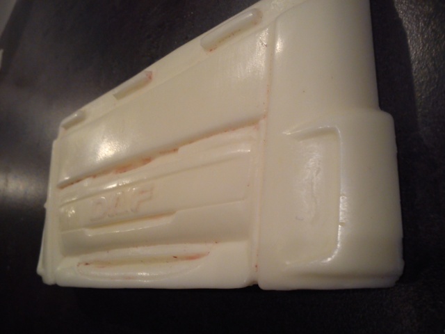

Old 03-03-2014, 01:59 AM
Default Re: DAF XF in tamiya scale
I hope to get the resin cab for the XF106 ready for the modelshow europe later this mounth.
here is the grill cast already.
and of corse it fits the same parts as the xf105. witch I hope it can have its debut too on that show.
gtz PetervR
