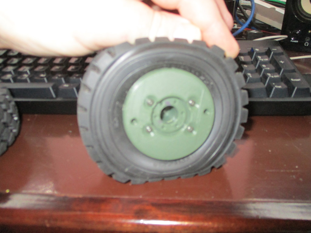

While greebling detail is not my strong point, I try where possible. One example is the wheels. RC4WD had a good military-tread tire that matched my scale, but I wasn't able to find anything remotely close to accurate for wheels. And even those that were available were crazy money. I got busy with the CAD then, and printed these up:
They're a beadlock, and a fair visual match to the 1:1.
Mind you, they're five pieces...
...and take half a day each to print, so doing 11 of them took a while. Not too bad, as once the design is set, you just hit "print another copy" ... but getting the dimensions Just Right to fit the tire lip took a lot of trial and error.
That's a slice view, and ouch, my head still hurts thinking about it.
The inside has a drive hex to match the axles, and then smaller hexes to press-fit M3 nuts into for the beadlock. Assembling beadlocks is hard enough, gotta use two long bolts to draw the halves together, then use shorter ones to assemble, without having to continually drop nuts off the back.
Jumping the gun a bit, found that the foams inside the tires were waaay too soft when the truck was laden. Being frugal and enterprising, I found that pool noodles can be had in about the right diameter, are cheap, and are easily cut with a foam wire cutter.
Again jumping ahead, those are actually for the trailer, but you get the idea. I've since switched to exclusively using pool noodles. With a bit of searching you can find them in different diameters, even solid-core ones sold for yoga or exercise, so you can use them on any size wheel.
Here's before
and then after, same force applied (using my carefully calibrated fingers.)

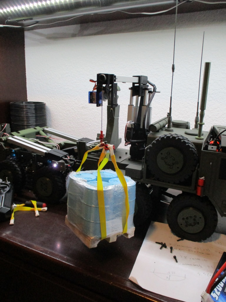

With the loading mechanism sorted, the next trick was the center loading crane. While it's not used to load the conex, it can be used to load stuff onto a flatrack.
This uses more linear actuators to lift up and down
and then another to move the arm in and out, with a 9G continuous rotation ("sail" or "winch"), with a little drum on the end to spool up the cable (well, string )
That all in turn is mounted on a skateboard bearing, with a 3D printed worm gear assembly driven by a regular size winch servo, pink and purple in the mockup. I find it handy to use the proper colors (ie olive drab) for parts which are "done" and then obnoxious colors for the parts I'm working on to more easily locate them.
and in the real world, getting a cat scan. Projects in this house get a lot of cat scans.
Actually setup, down:
and then checking clearance over the hook:
With moving parts like this, geometry comes into play more than I'd like. Turns out that when the crane is lifted so it clears the hook, the reach is reduced. As mentioned, ended up with a switch to choose one of three crane positions, one with reduced height but at an angle to give maximum reach. It will rotate over about 270* of the cab, and drop loads into the flatrack to about half the length back.

Axles are just M4 threaded road; the wheels then have brass tubes of ~4mm ID to act as bushings to spin freely on the axles.
a little snap on cap for the hubs
and they're a close match for the 1:1
The tired tread isn't quite right, but I couldn't find a closer match in the right size.

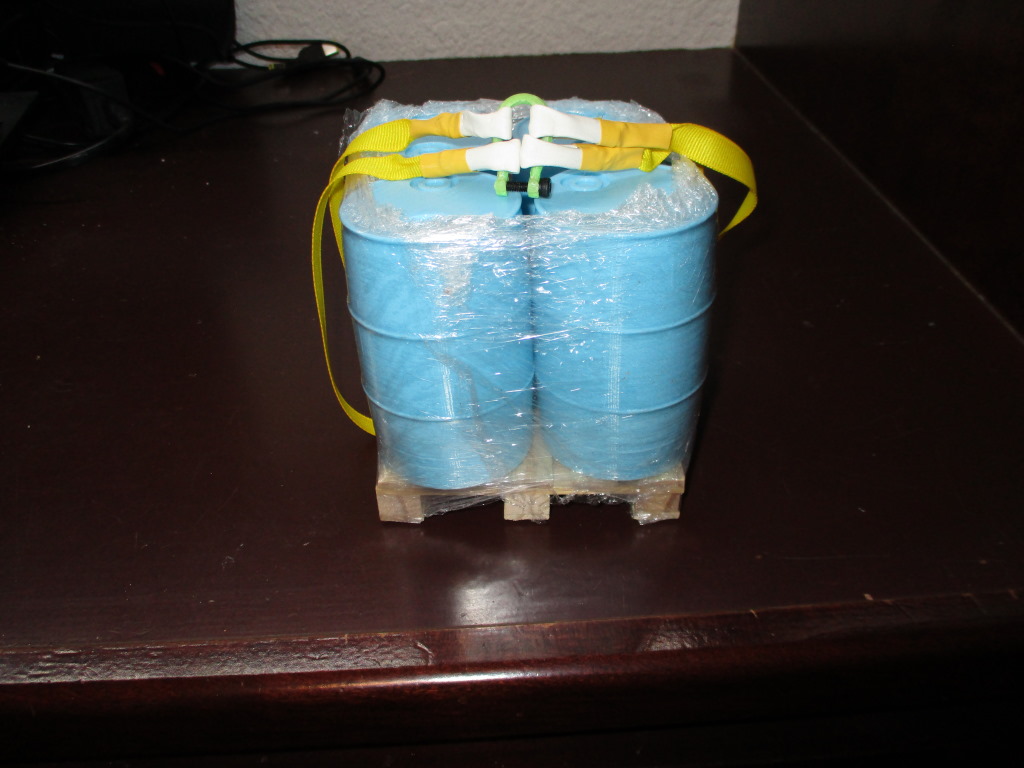

55 gallon drums come right off the printer, and are then shrink wrapped onto a pallet with longer versions of the straps above. The missus was surprised when I asked for Saran Wrap, and laughed at how long it took me to get it wrapped tight around the drums. They're sneaky little buggers.
Another place the "print another copy" is handy. You want different colors? No problem. Feed in another spool, push the button, boom. These are actually hairy to CAD up as the military Sceptre-branded ones are stupidly shaped, but I have a set out in the garage to work from. Note the blue water one is a bit different from the others. The "20L FUEL" label doesn't quite come through, maybe a bit of X-acto knife work would help.

I was surprised that the crane's winch is strong enough to lift these, even without a snatch block
