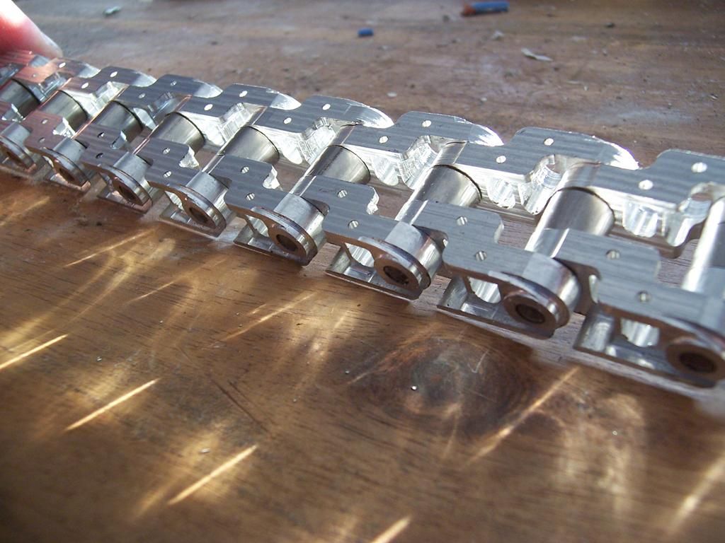

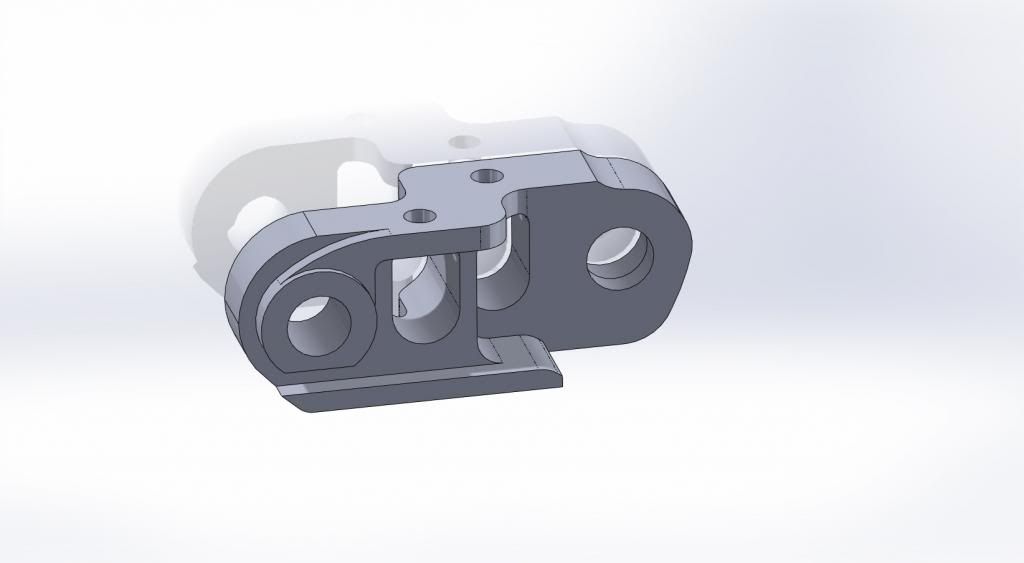

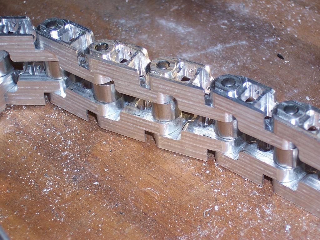

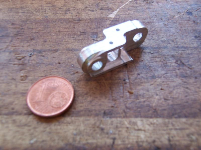

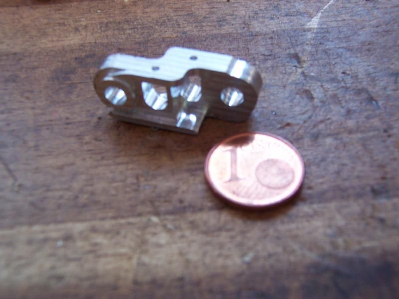

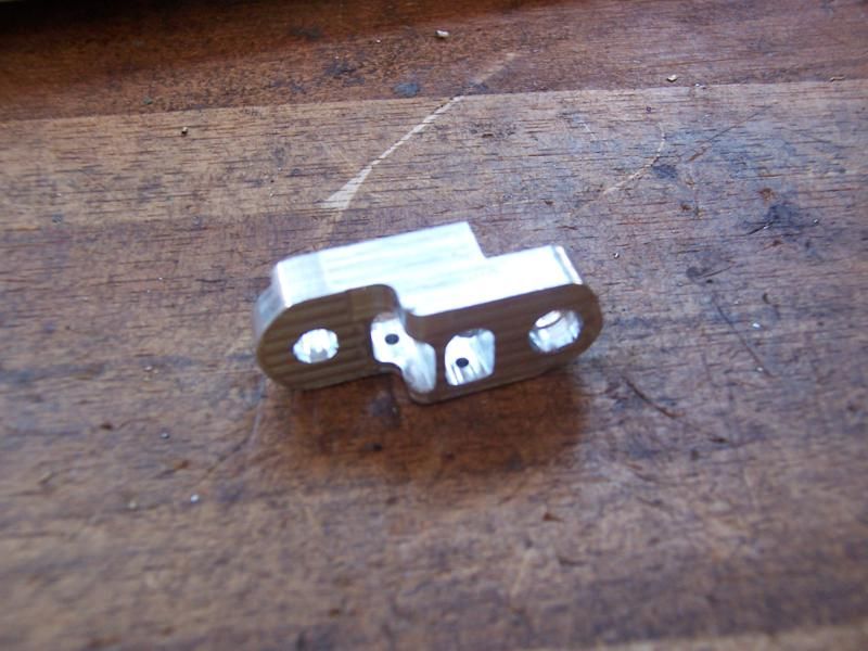

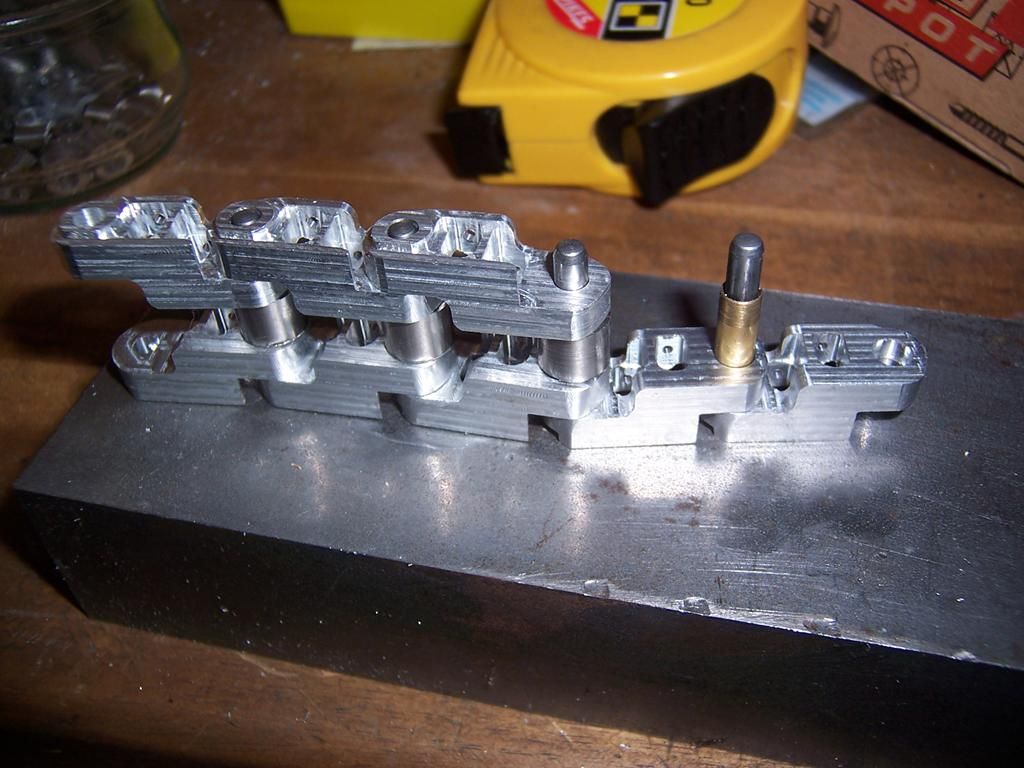

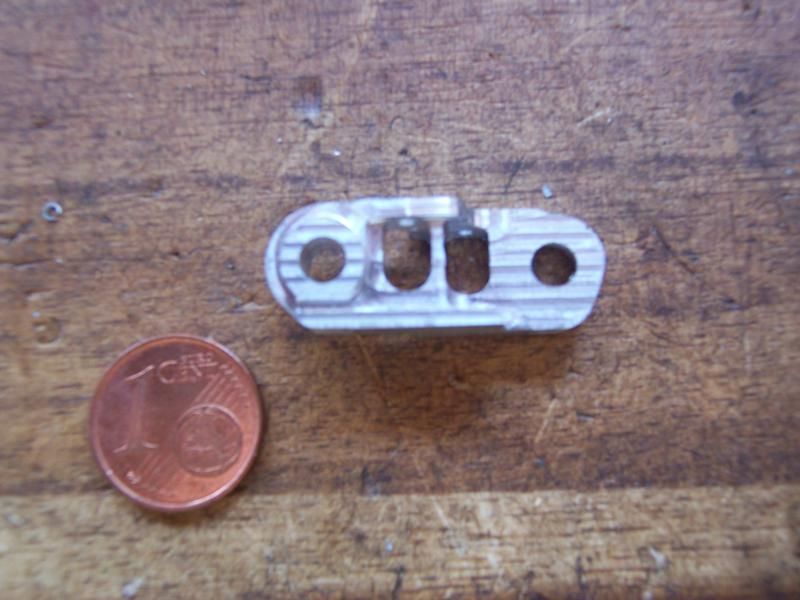

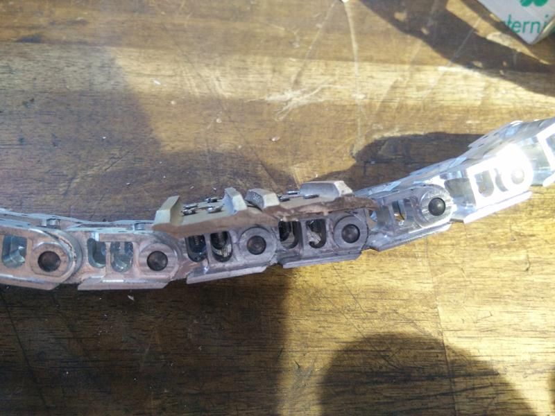

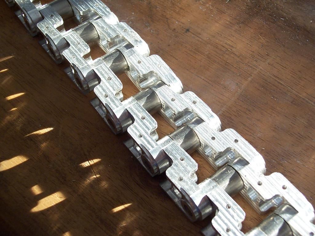

the first piece is a link of the chain
http://img.photobucket.com/albums/v2...0.jpg~original
http://img.photobucket.com/albums/v2...3.jpg~original
http://img.photobucket.com/albums/v2...4.jpg~original
http://img.photobucket.com/albums/v2...a.jpg~original
http://img.photobucket.com/albums/v2...d.jpg~original

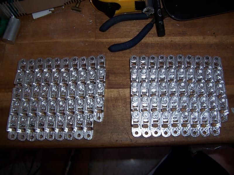

i have to machining 196 links, a preview model

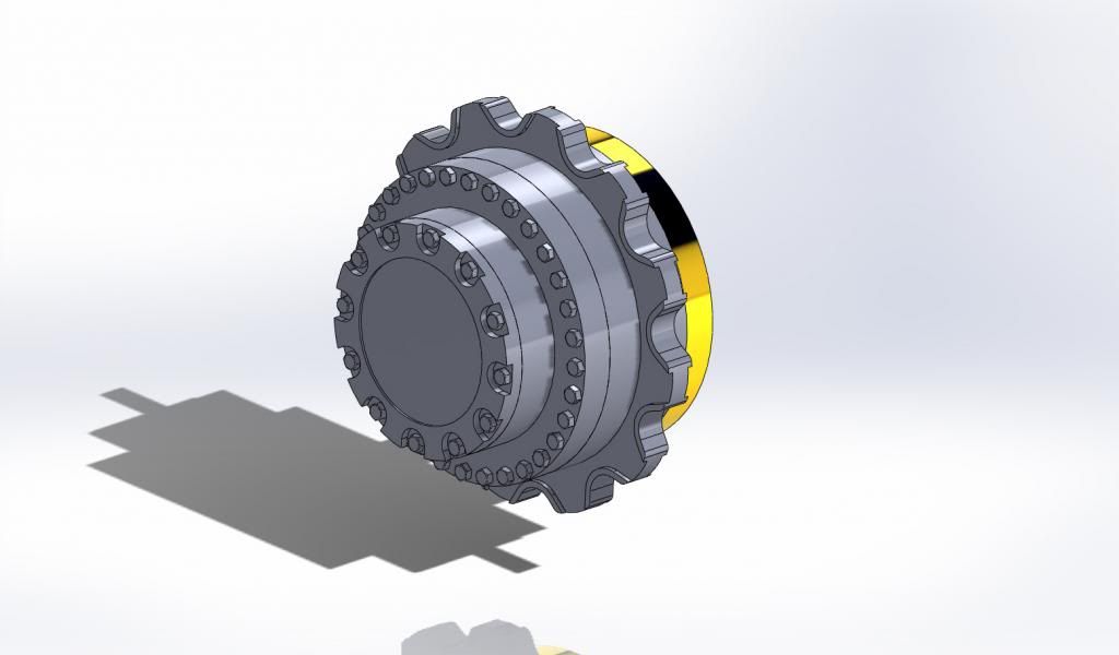

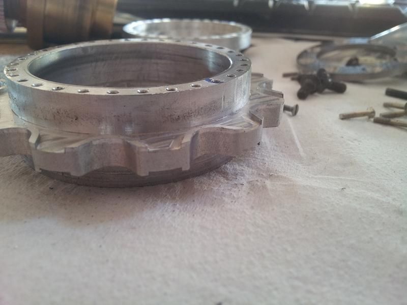

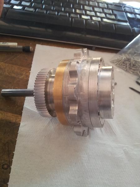

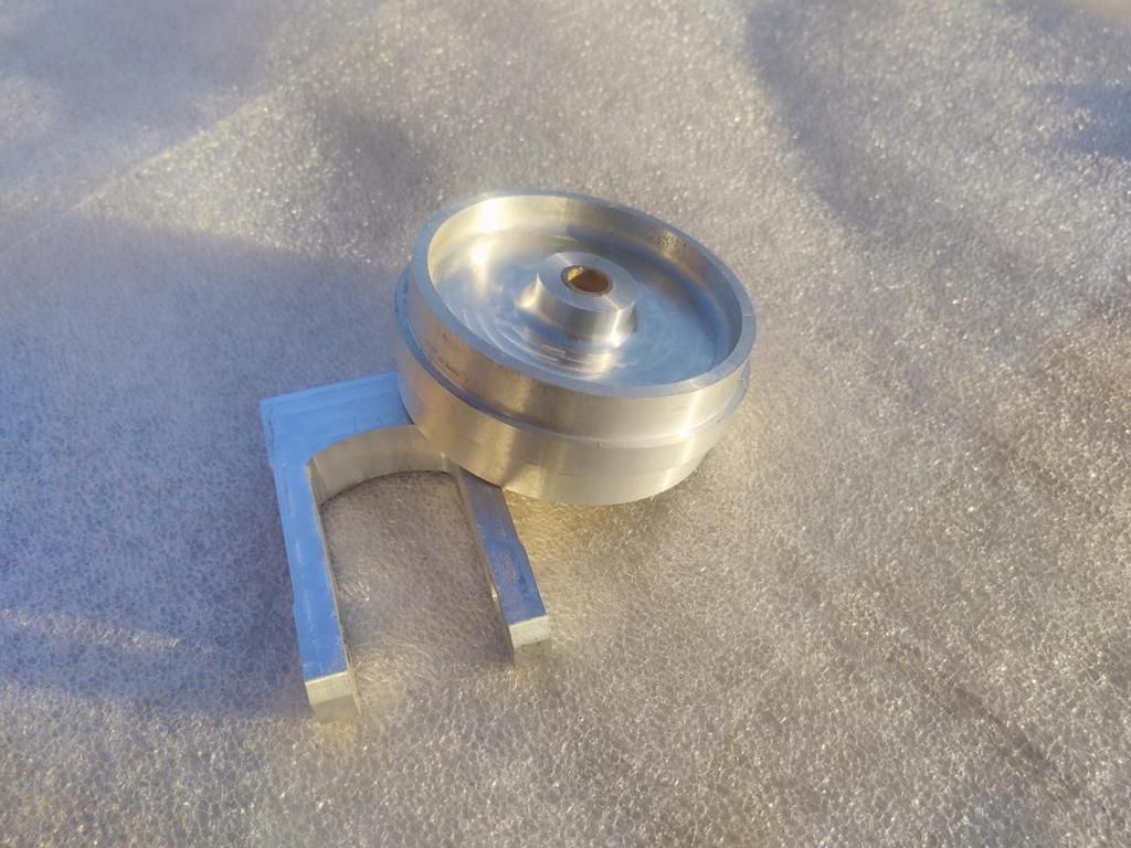

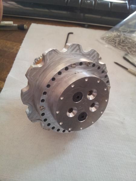

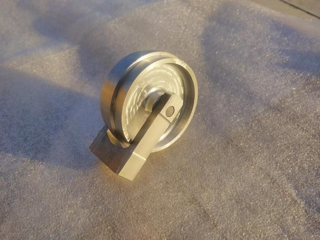

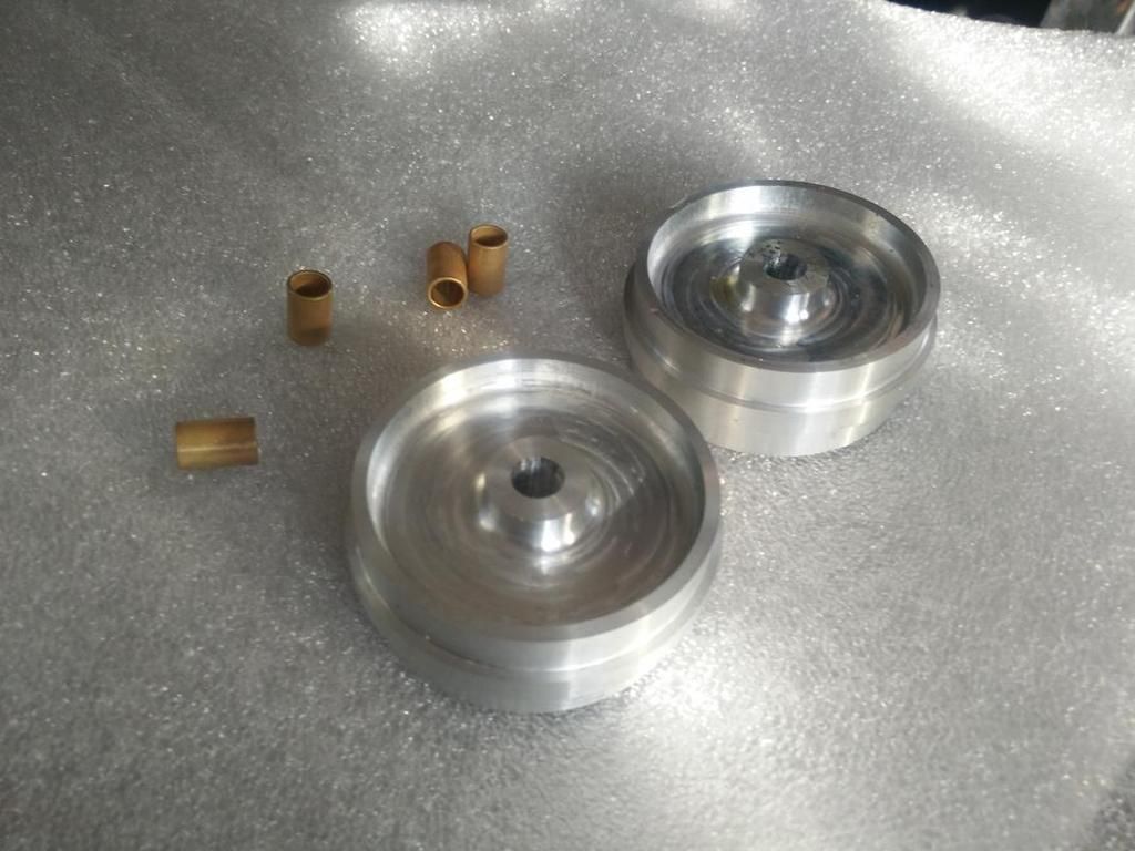

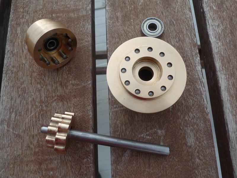

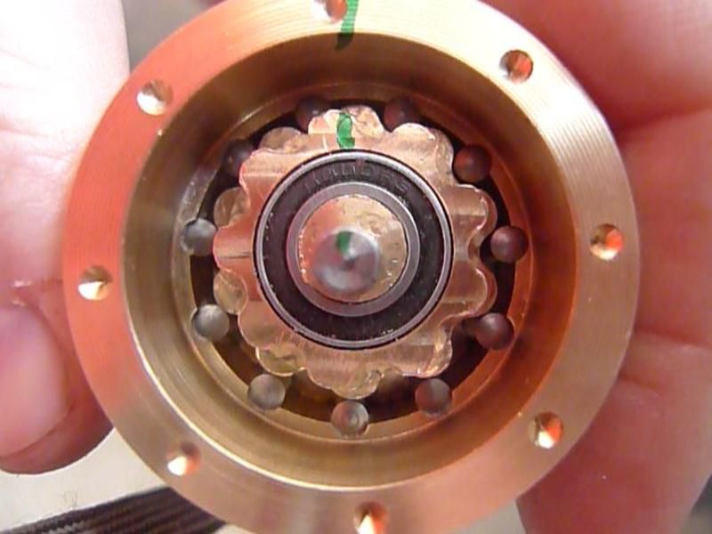

the traction wheel:
i use a cycloid gear inside the wheel cube with a relation on 1:100 and i turn this shaft using a timing pulley with a 1:6 relation --> final relation 1:600

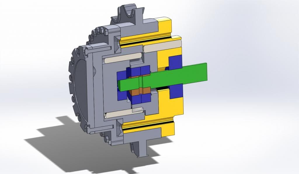

sectional cut
http://img.photobucket.com/albums/v2...8.jpg~original
http://img.photobucket.com/albums/v2...7.jpg~original
http://img.photobucket.com/albums/v2...f.jpg~original
videos
http://www.youtube.com/watch?v=vtx9vAy3h9I
http://www.youtube.com/watch?v=jrk4c-XzaZA

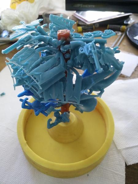

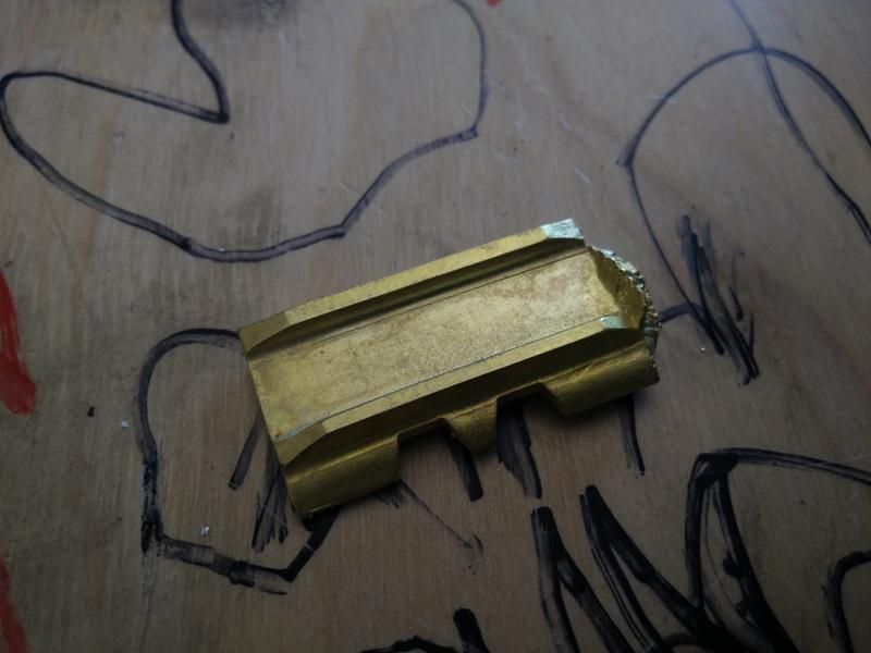

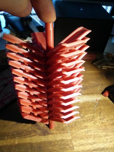

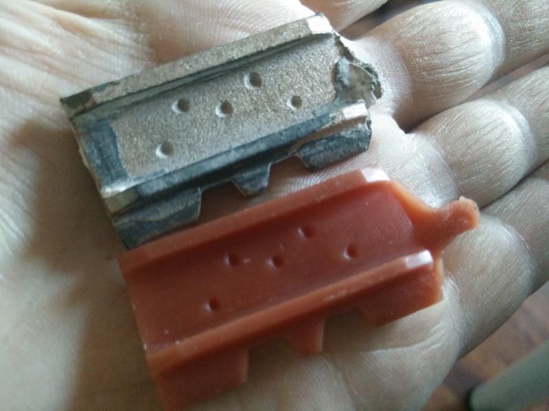

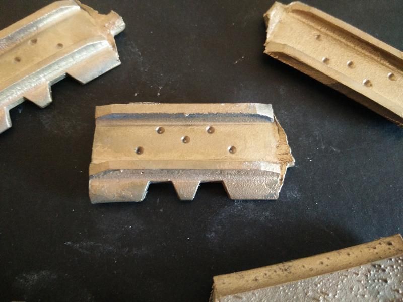

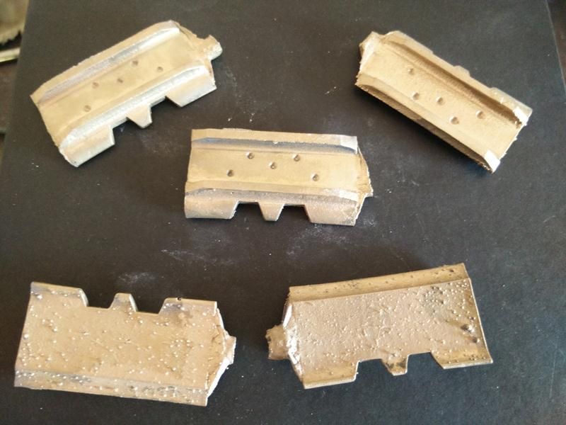

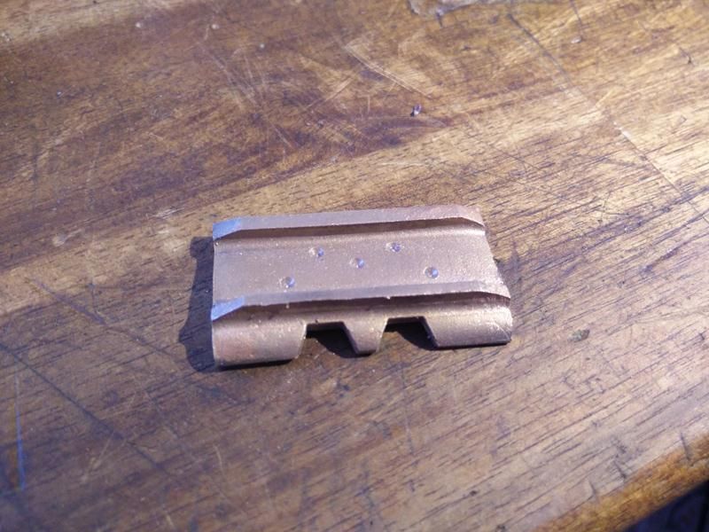

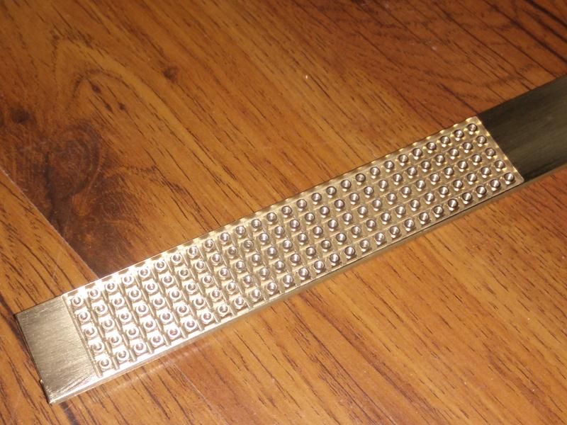

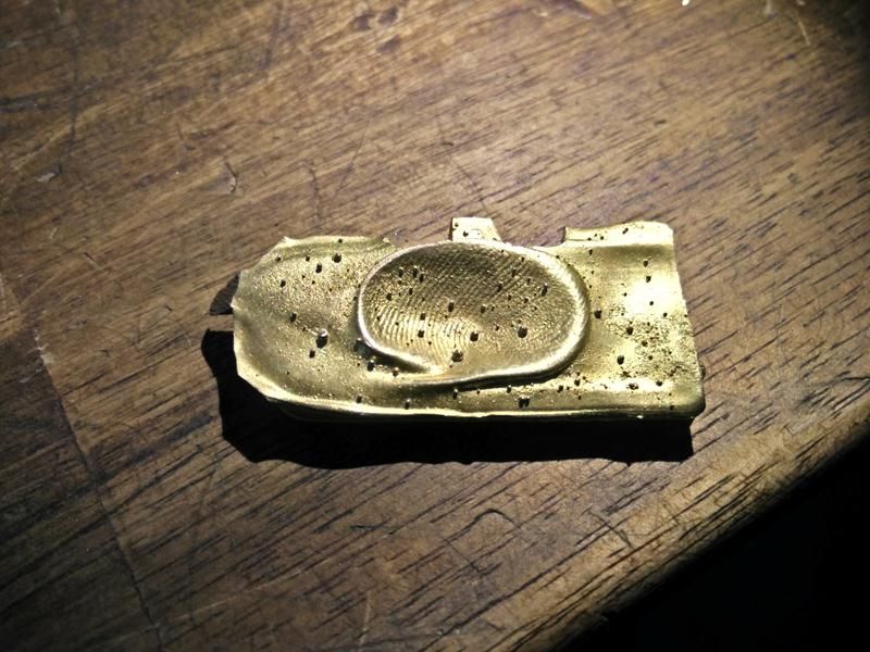

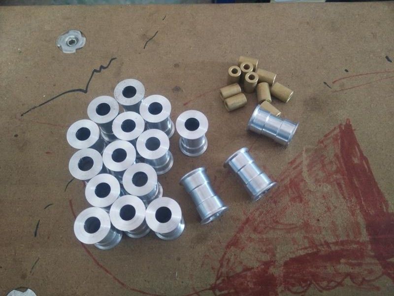

ok, this is the current status , i need to make the pads for the chain, at the first place i thought to machining it, but i have to rotate them in the mill many times, too boring, i had to learn another technique, lost wax casting
the first cast (bronze)
http://img.photobucket.com/albums/v2...5.jpg~original
http://img.photobucket.com/albums/v2...b.jpg~original
http://img.photobucket.com/albums/v2...c.jpg~original
http://img.photobucket.com/albums/v2...1.jpg~original
http://img.photobucket.com/albums/v2...2.jpg~original
tessen 01-28-2016 05:43 PM
Re: Liebherr R984 1:14
http://img.photobucket.com/albums/v2...f.jpg~original (obviously these are not the final screws)
http://img.photobucket.com/albums/v2...e.jpg~original

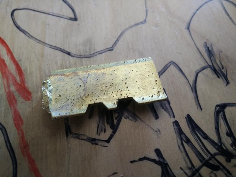

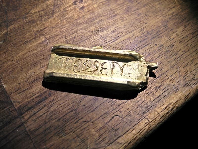

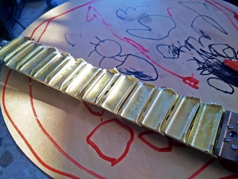

the second cast (brass)

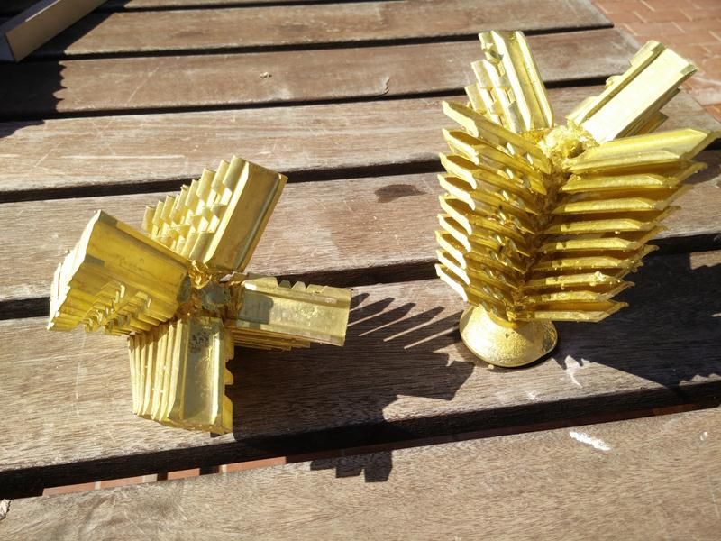

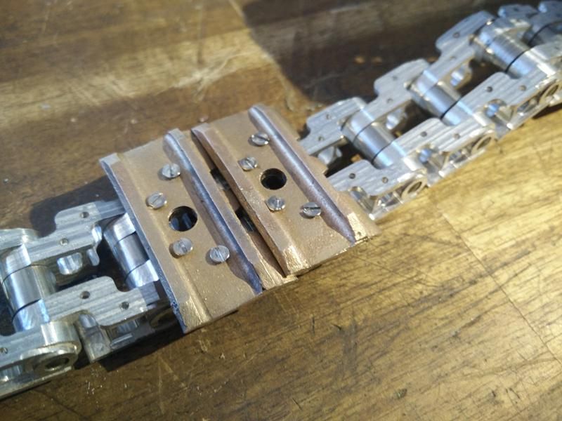

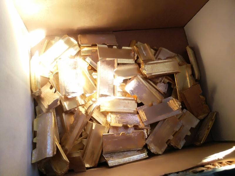

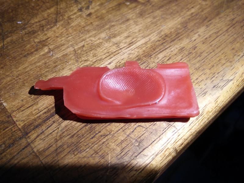

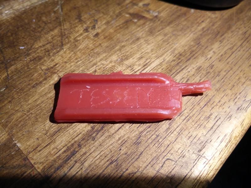

the third cast (brass)
the third cast was better, i made the pads i need and i do a test cast, to see that this technique is able
the wax test cast

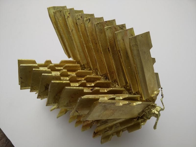

the final cast
my pads cast

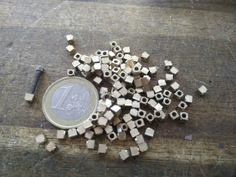

Well, these are the most important pieces, now it make a dotted and drill (which has no mystery), one thing that if it could be funny / curious, are the nuts with hex screws that hold the pads to the chain, finally i did it with my cnc router, the pieces were made in brass, nuts are threaded to M2 and measure 3x3mm, totaling 405 nuts, machined with a 1.5mm drill (the champion of end mills)
http://img.photobucket.com/albums/v2...9.jpg~original
a little video of the machining

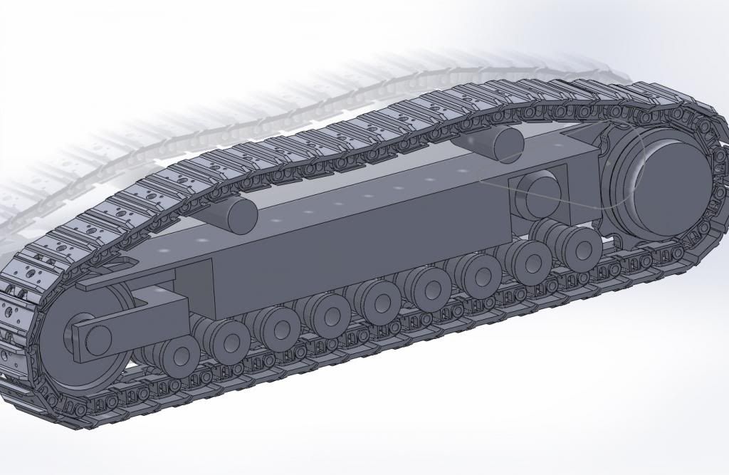

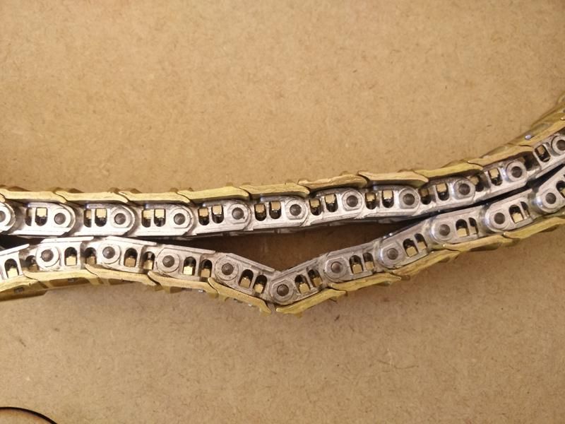

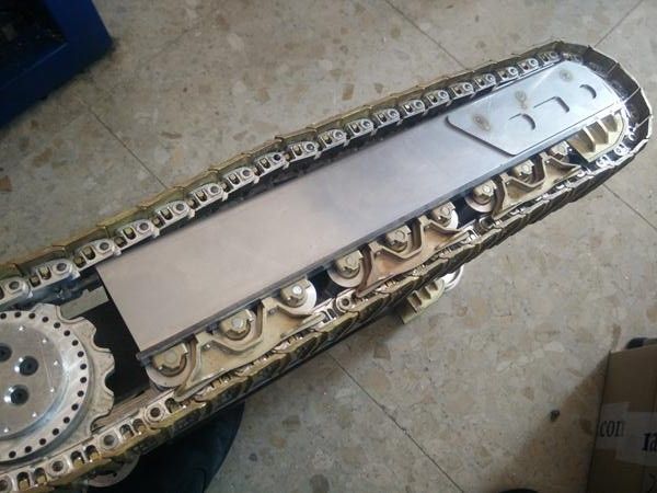

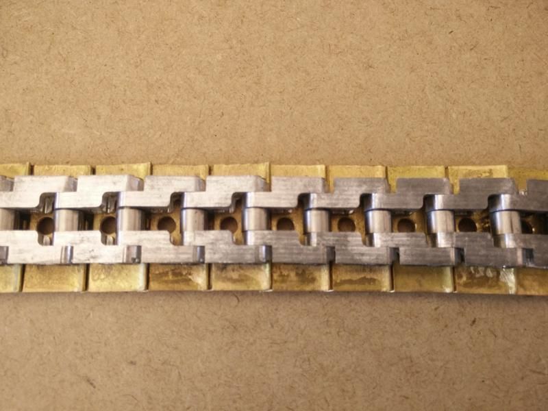

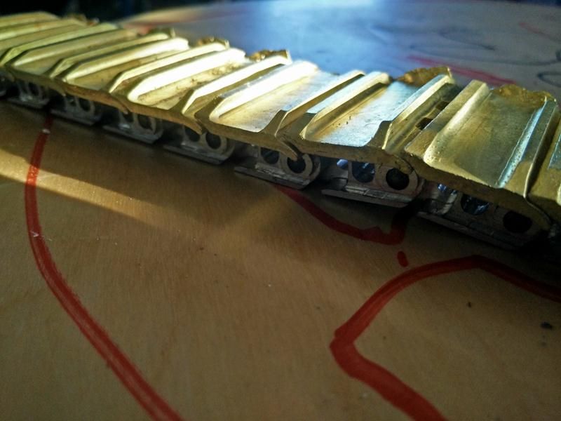

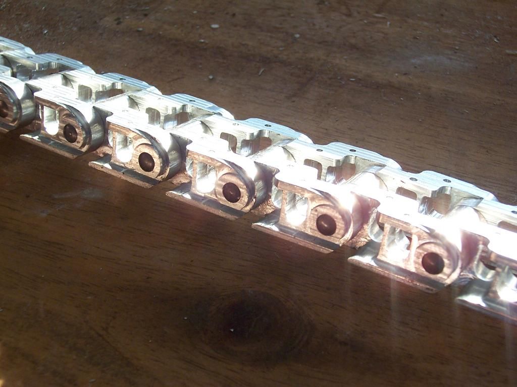

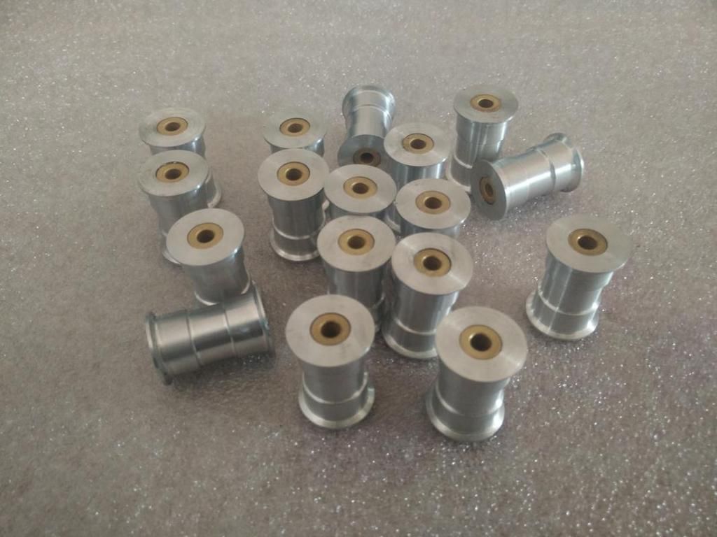

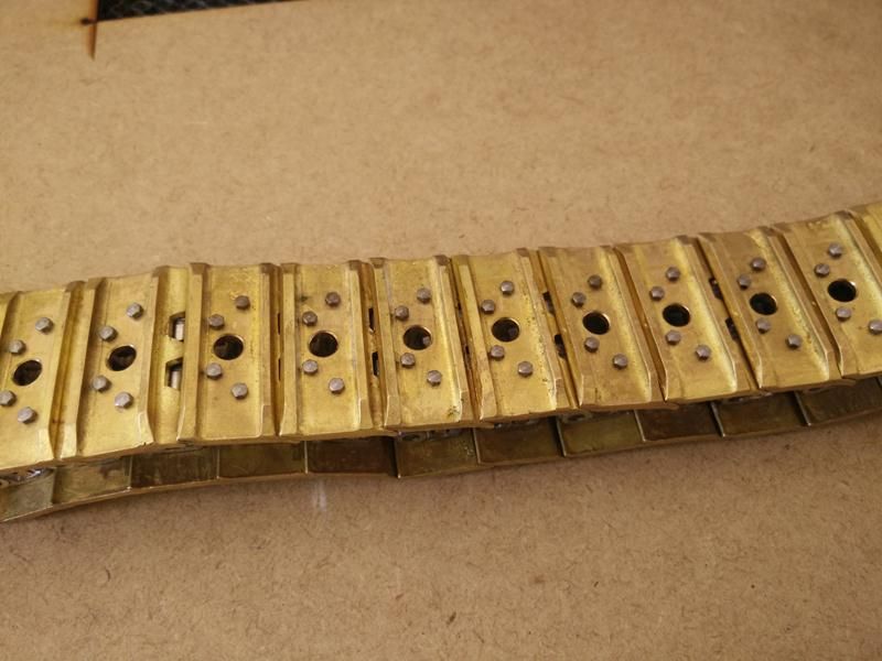

and finally .. I could assemble the track

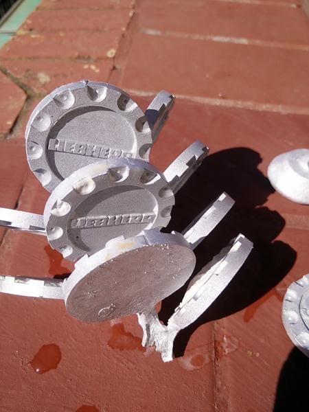

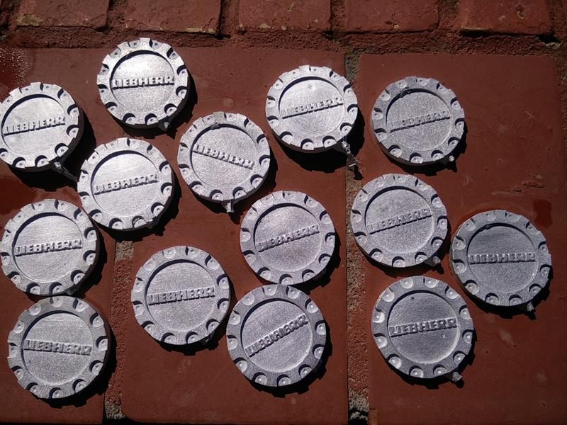

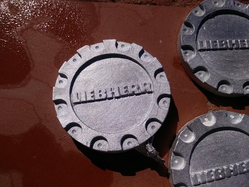

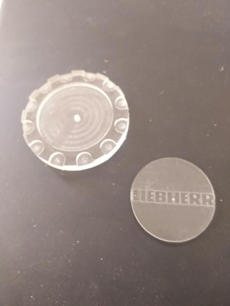

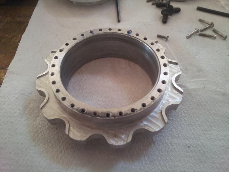

more photos, this is the time of the hubcaps for the traction wheel, made of aluminum
the master piece is made in 2 pieces, one milling and the other are made using laser engraving
after that, both are join
the mold and the wax copies
the result of the casting

Is the advantage of a cycloid reduction a thinner package than a planetary? Watching the video of you spinning it fast with a drill, it looks like there may be some vibration to it... :thinking:
tessen 01-29-2016 05:39 PM
thanks for comment
i progress too slowly, now i´m making the hydraulic valve block i hope to share the test soon
Lil Giants: cycloidal reduction have many advantages, some are:
- if you turn the output axis, the input axis can´t be move (brake system)
- there are more surface in contac--> can manage bigger loads
- the output axis have a big diameter
in the video there are 2 stages of 1:10 (total 1:100) but this is a first test, now i have 2 stages of 1:15 (total 1:225) in the same place (and could increase the final relation) to obtain this is complex with spur gears (but i don't say you that it can't be done)
on the negative side this gearbox are difficult to machining, nevertheless i´ll i use it on the chain and in the turret turn
regards

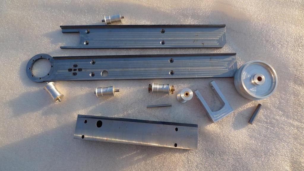

tessen 05-02-2016 05:38 AM

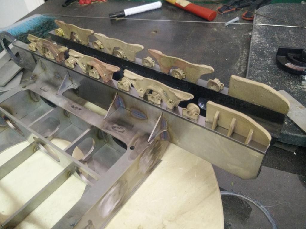

more advanced, the lower structure, all stainless steel 3 mm and 1.5mm
http://img.photobucket.com/albums/v2...h.jpg~original
http://img.photobucket.com/albums/v2...l.jpg~original
http://img.photobucket.com/albums/v2...m.jpg~original
http://img.photobucket.com/albums/v2...z.jpg~original
http://img.photobucket.com/albums/v2...q.jpg~original
http://img.photobucket.com/albums/v2...j.jpg~original
the following photos correspond to the lost wax casting of pieces for support and guides rollers on tracks
http://img.photobucket.com/albums/v2...t.jpg~original
http://img.photobucket.com/albums/v2...n.jpg~original
http://img.photobucket.com/albums/v2...u.jpg~original

i will do the "tooth" and "tooth holder" with lost wax process, but using 3D printer technique (ussing a diy 3D printer), first time, to make the 3D print model (i use different types of resin)
https://i.imgur.com/vLxZC83.jpg
https://i.imgur.com/XhXWVPy.jpg
https://i.imgur.com/naP07TT.jpg
https://i.imgur.com/LtWjnzT.jpg
https://i.imgur.com/wLEyT5g.jpg
https://i.imgur.com/mwclA5J.jpg
https://i.imgur.com/bYdvRjY.jpg
https://i.imgur.com/CGSf1L3.jpg
https://i.imgur.com/wDoaYLr.jpg
now i use those part to make silicone models to obtain wax parts
https://i.imgur.com/lY5bDxL.jpg
https://i.imgur.com/935XFz1.jpg
https://i.imgur.com/K1P6xki.jpg
https://i.imgur.com/mgXVb5S.jpg

the pieces welded by brazing
https://i.imgur.com/k2KBCqc.jpg
https://i.imgur.com/x99bc7k.jpg
https://i.imgur.com/pmyWrL7.jpg
https://i.imgur.com/kZvQJkM.jpg
https://i.imgur.com/v2GRvFN.jpg
https://i.imgur.com/UEIlu99.jpg
and almost finished (yet not, I have to add minor details)

the previous piece need on both sides spacers, made of brass and using sand casting technique, those part are glued with epoxy to the main body, but it´s not important, once time in place, can´t move
https://i.imgur.com/uJgSwYf.jpg
https://i.imgur.com/sHFUFFs.jpg
https://i.imgur.com/KMkeqQV.jpg
https://i.imgur.com/Bm2wifd.jpg
https://i.imgur.com/l8H97ki.jpg
and after machining
https://i.imgur.com/noP6JCj.jpg
https://i.imgur.com/aA0TSHy.jpg
https://i.imgur.com/nntrhNR.jpg
https://i.imgur.com/wu8TRd4.jpg

the turret turning system
https://i.imgur.com/3mfrSfo.jpg
https://i.imgur.com/EQb4t6a.jpg
https://i.imgur.com/uAtzYiX.jpg
https://i.imgur.com/Z9vhbtS.jpg
https://i.imgur.com/vLRbS2e.jpg
https://i.imgur.com/NtfZrZg.jpg
https://i.imgur.com/RhTw5KZ.jpg
https://i.imgur.com/rYeUiII.jpg
https://i.imgur.com/p8e4mzQ.jpg
https://i.imgur.com/NjRH0S6.jpg
https://i.imgur.com/xjtYoYw.jpg
https://i.imgur.com/LweqbT0.jpg
https://i.imgur.com/4gm4AS9.jpg
https://i.imgur.com/Z2nqjxt.jpg
https://i.imgur.com/RrWocRD.jpg
a little video of the motor and the gearhead
https://youtu.be/6APESpE42aY
and the rest of gearhead
https://i.imgur.com/fwSkLqw.jpg
https://i.imgur.com/b7tf08f.jpg
and a video to show how it´s works
https://youtu.be/oIVaSKgdFJg
