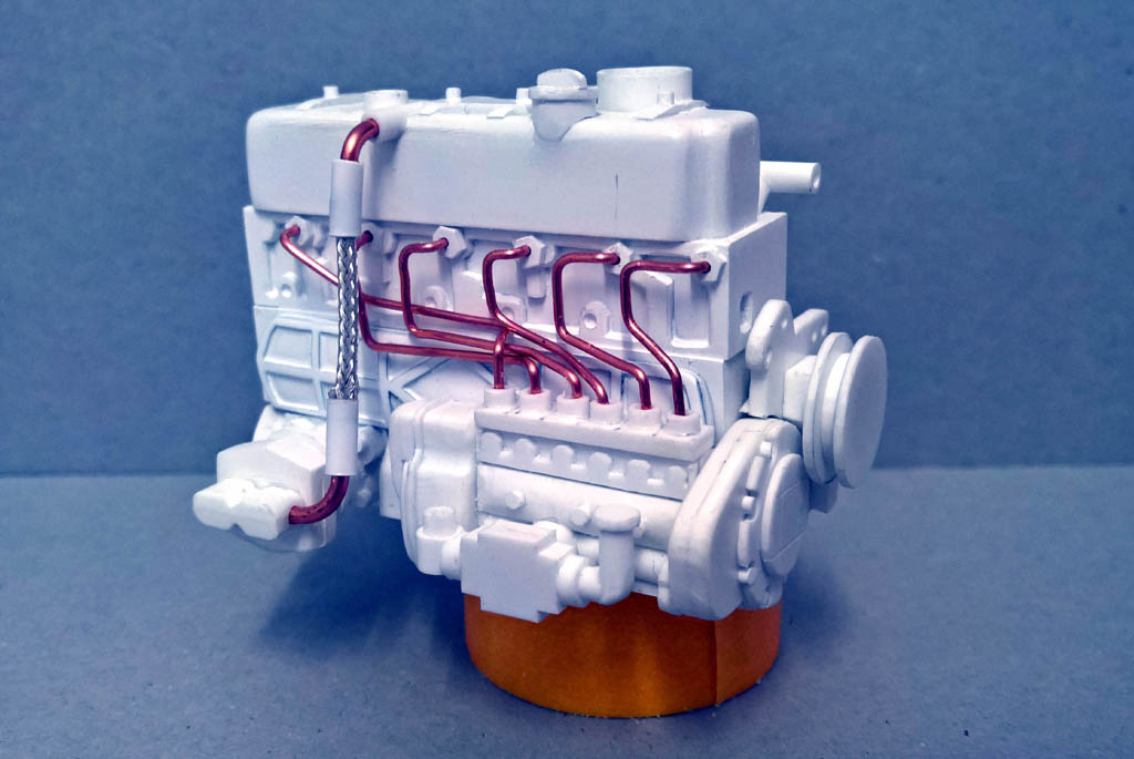

Recently built a replica of an OM 352 (engine in the Unimog 416). Given that it turned out semi-ok I'm going to attempt an OM 346 for this build.

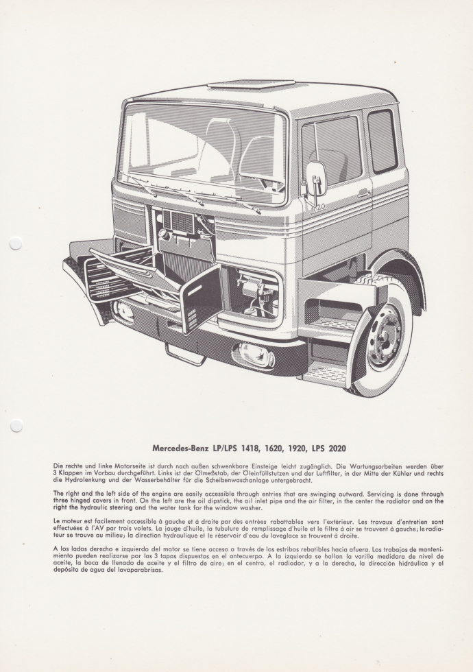

Found some original promotional reference material for the truck and the engine -
More later tonight.

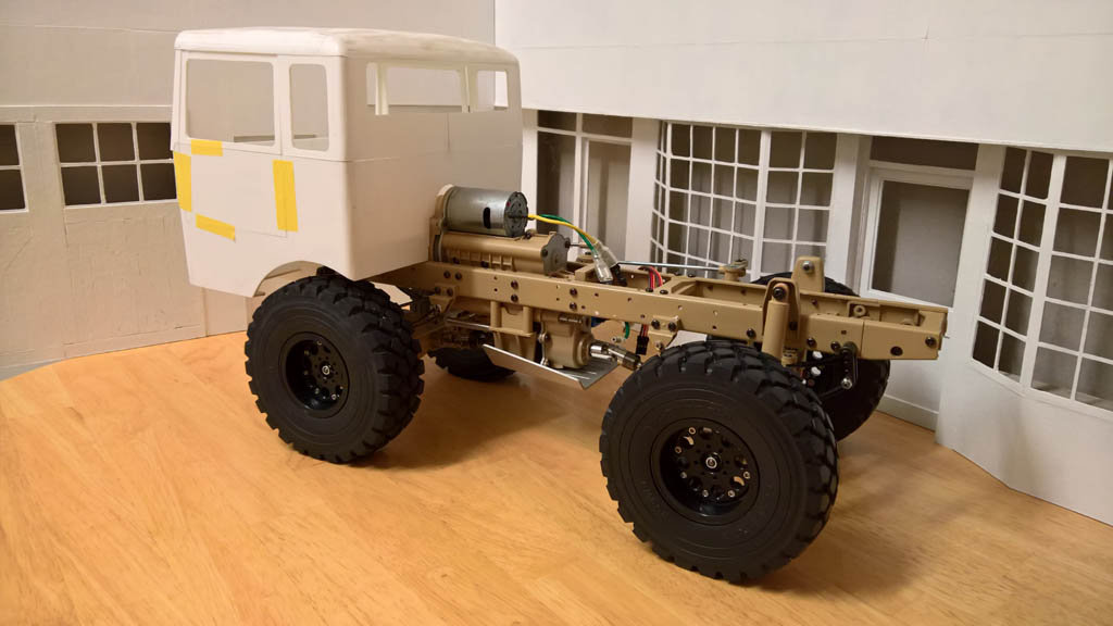

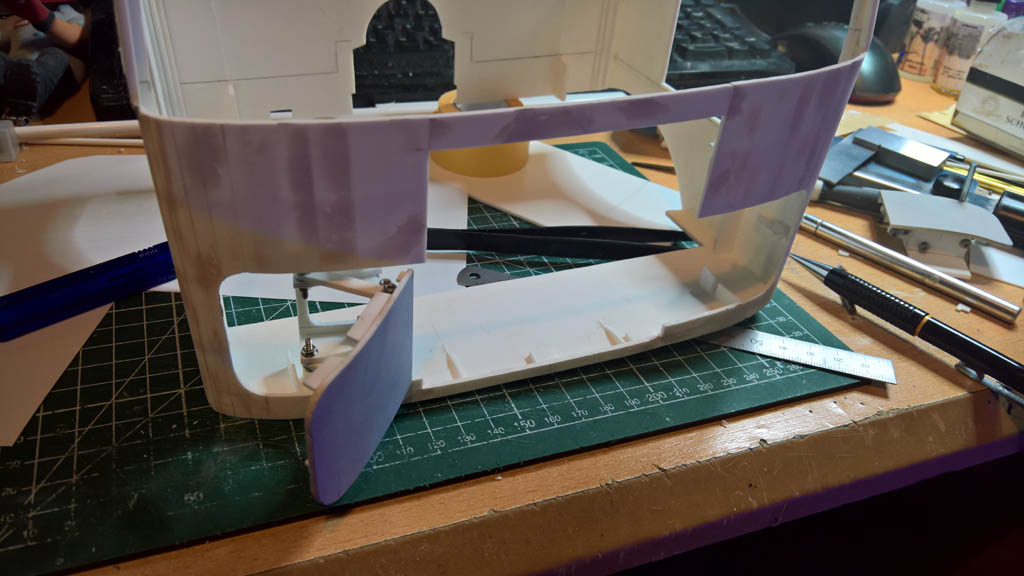

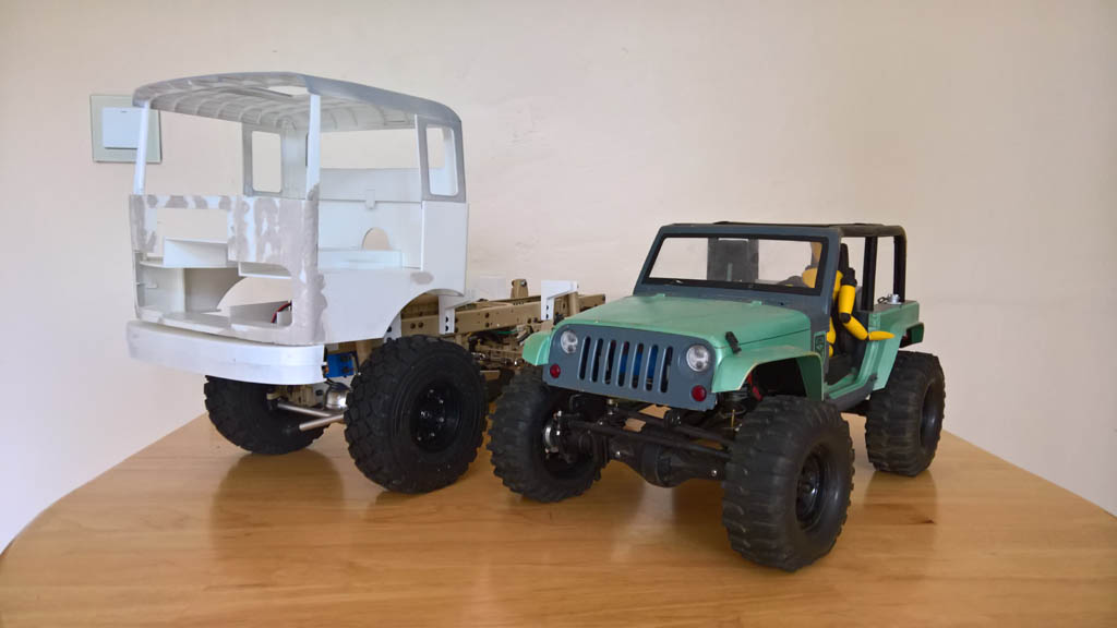

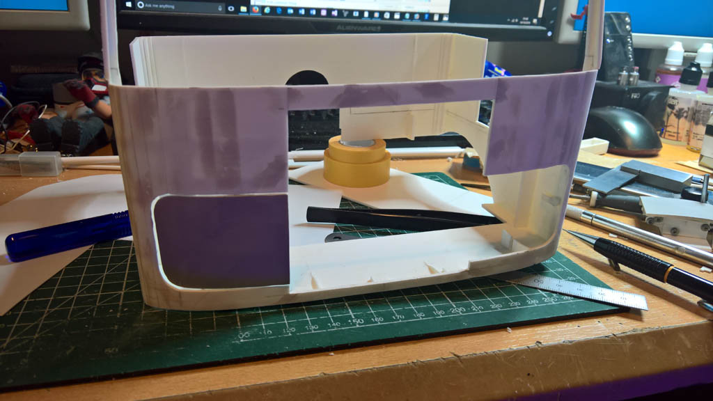

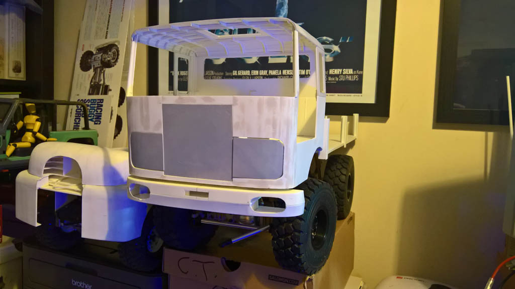

Right, progress. I'm about 3 weeks into this build.

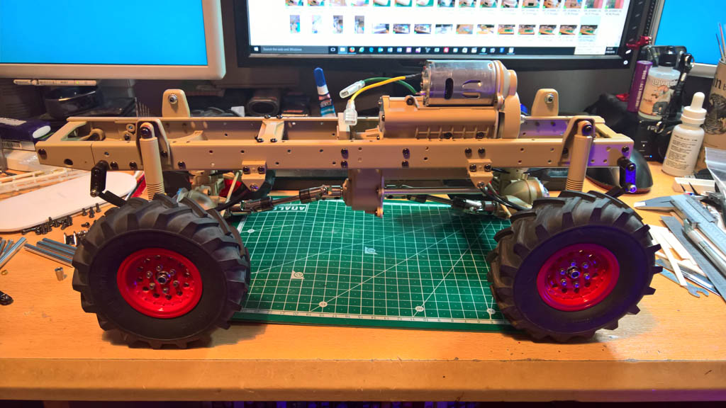

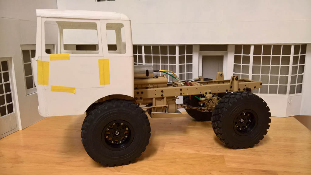

Ordered a Tamiya Hilux High Lift kit from Hong Kong, and built it. I sized the build to the track width of this kit (220mm), which pegs scale at ~1:10½.
Didn't bother with things like servo covers, electrics tray and battery holder, as I'll make my own. Then I started on the cab.

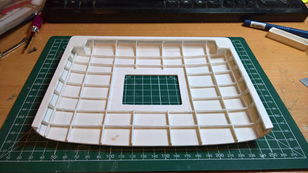

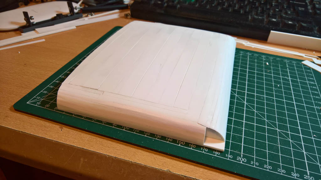

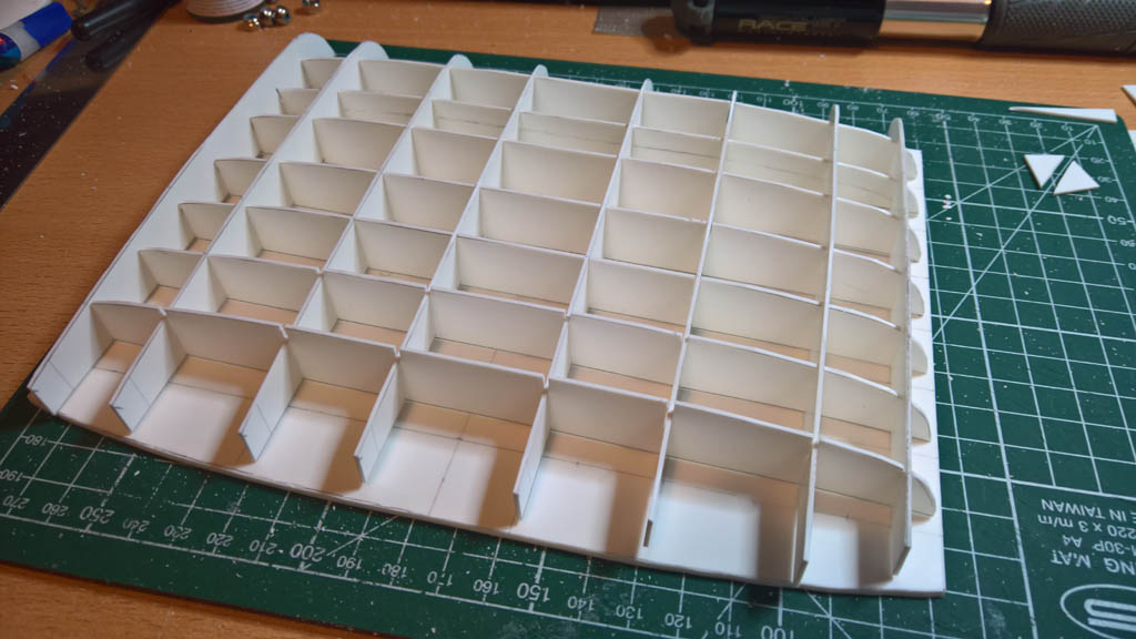

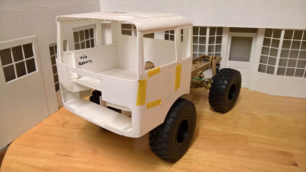

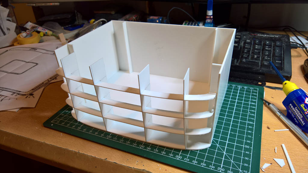

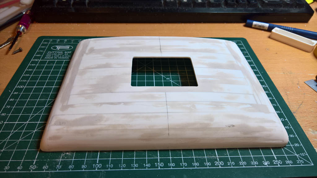

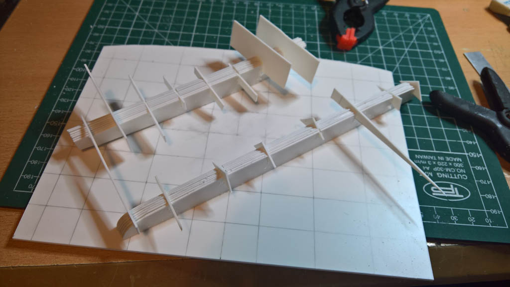

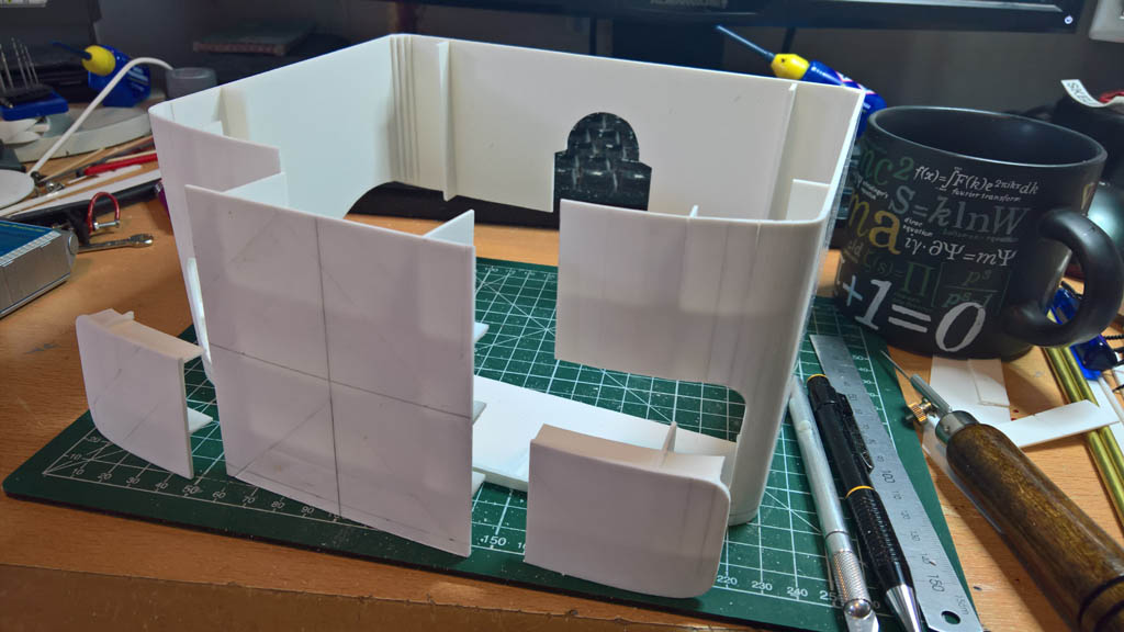

Cut out some roof ribs, and notched them so that they'll slide into each other to provide accurate contours.
Dry-assembled it...
...and put a skin on it.
That 2mm base plate is coming off before it goes on the body, but that aside the roof is done.
Styerene at bottom right is a little thin and needs surgery...

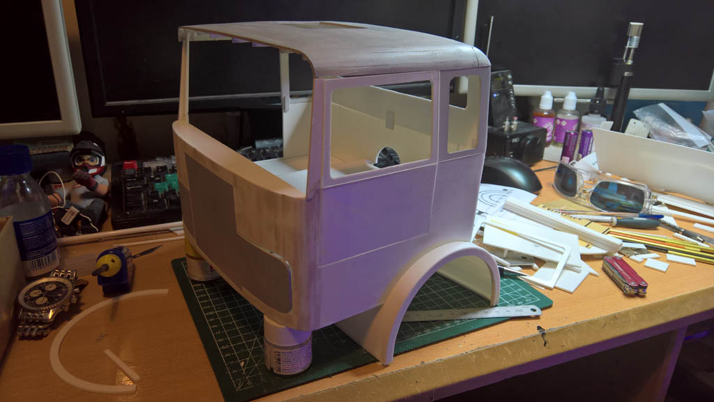

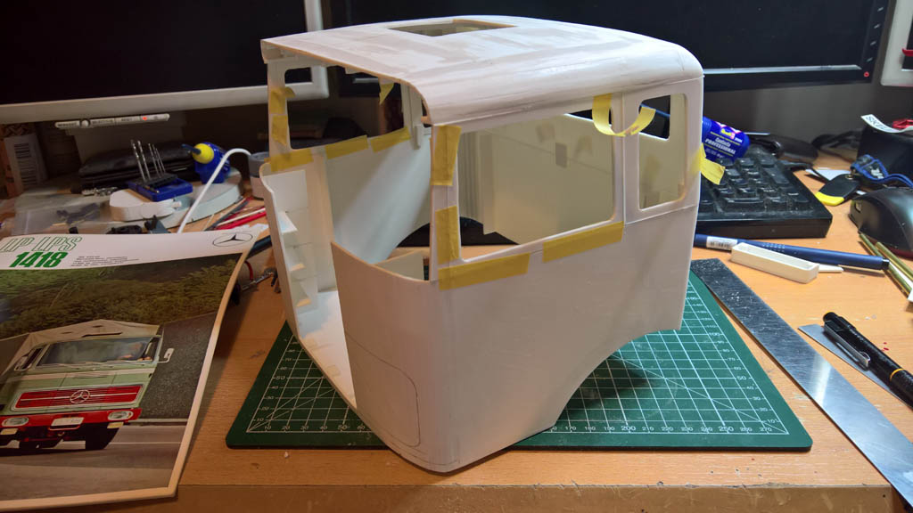

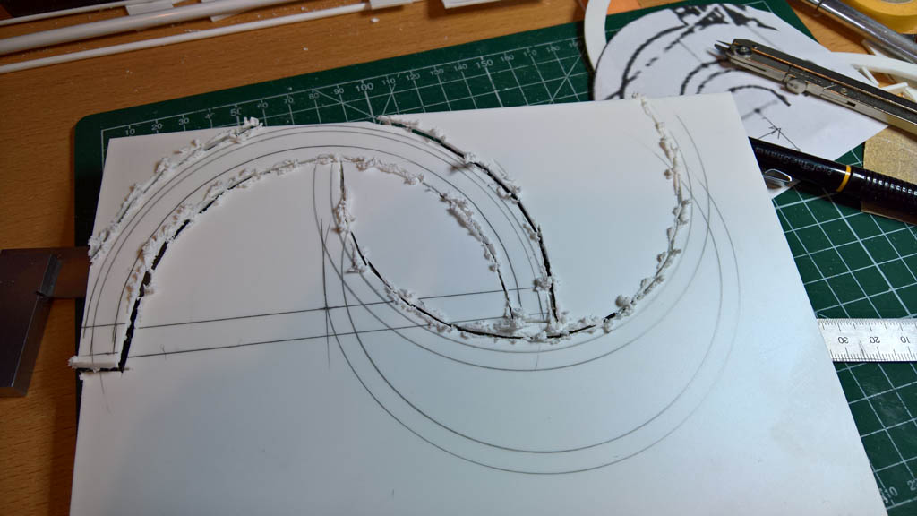

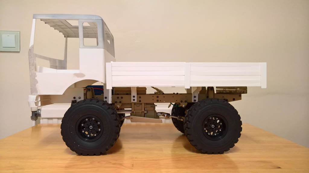

Next step was to get the cab mounted on the chassis. Also cut out the grill, and played with some tyre/tire (delete as appropriate) sizes.
Which brings us up to date, pretty much. More to come as it happens.

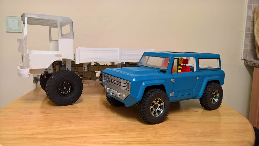

Haven't given the loadout much thought. Probably just something like the picture below, which really captures the essence of the truck as I remember it from my childhood.

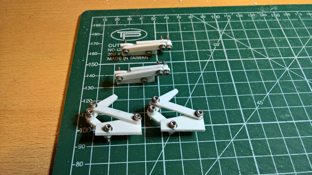

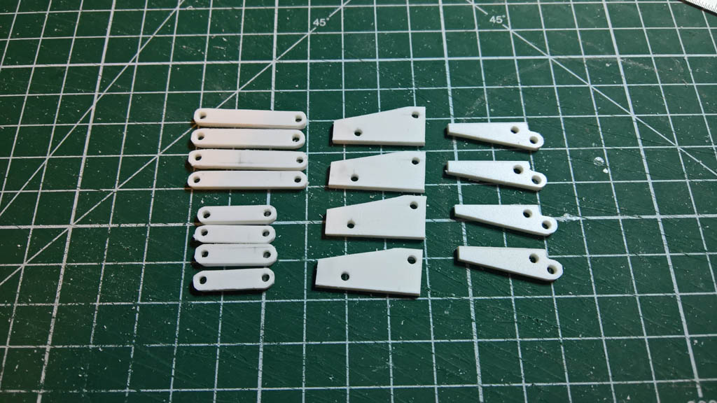

Made some progress today. Cut out the pieces I'll need for the hinges on the grill. M1.6 and M2 bolts arrived, but no nuts, so that's as far as the hinges went.

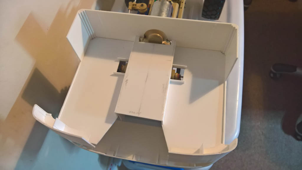

Made a start on the inside instead. The floor is done, bar the clean-up.
Happily there's heaps of space in there for an engine.

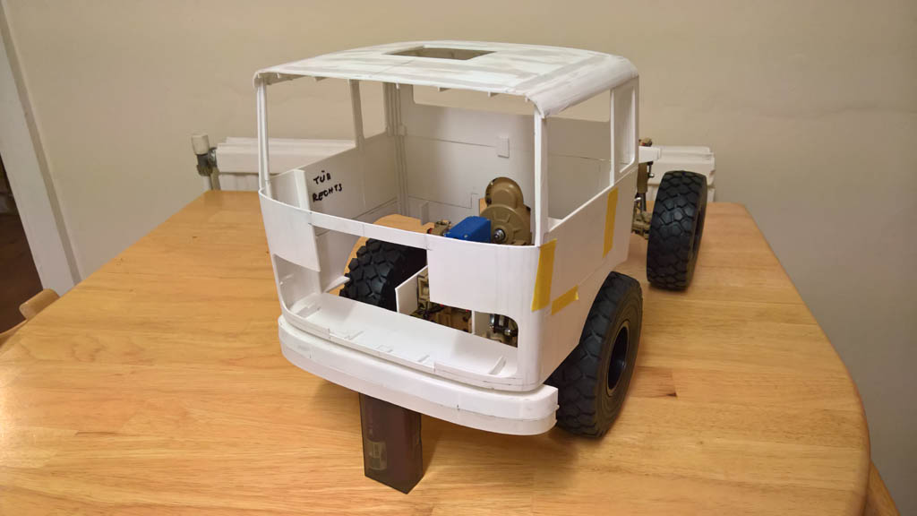

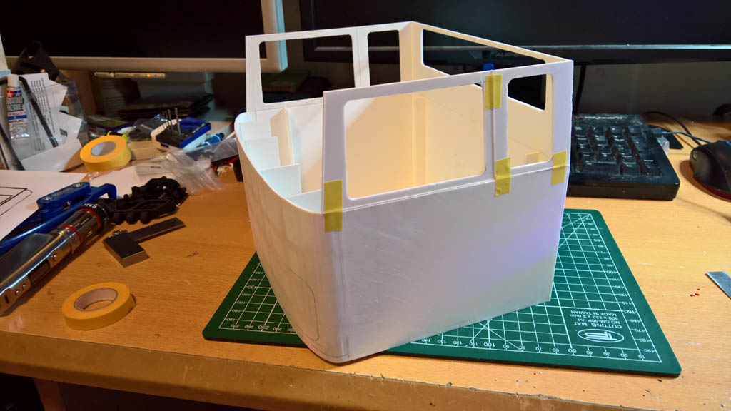

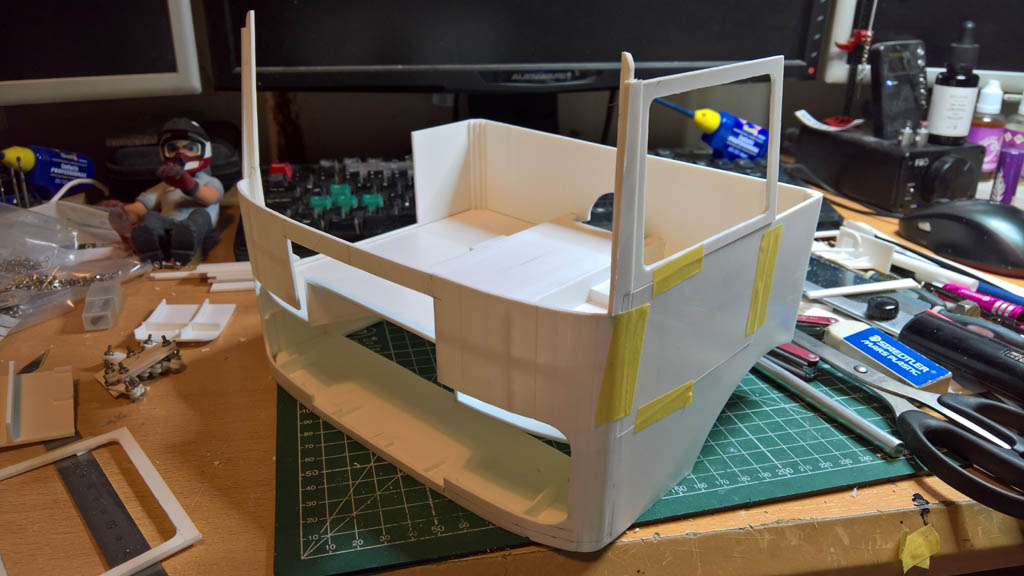

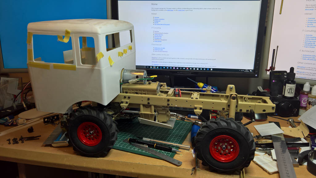

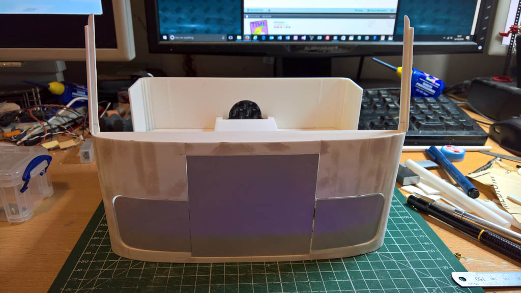

Been working like crazy on this thing without much to show. Most of it was working back the ribbing and trying out different ideas for door hinges and pillars. Also managed to assemble the grill hinges, but haven't stuck them in yet.
The pillars were hard going. Well, putting them in was easy enough, once I'd worked out how it would hold a windscreen and support the roof.
Window frames are just resting on their own weight, so look a little more sunken in than they should.

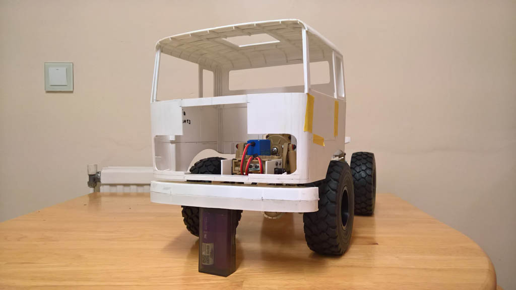

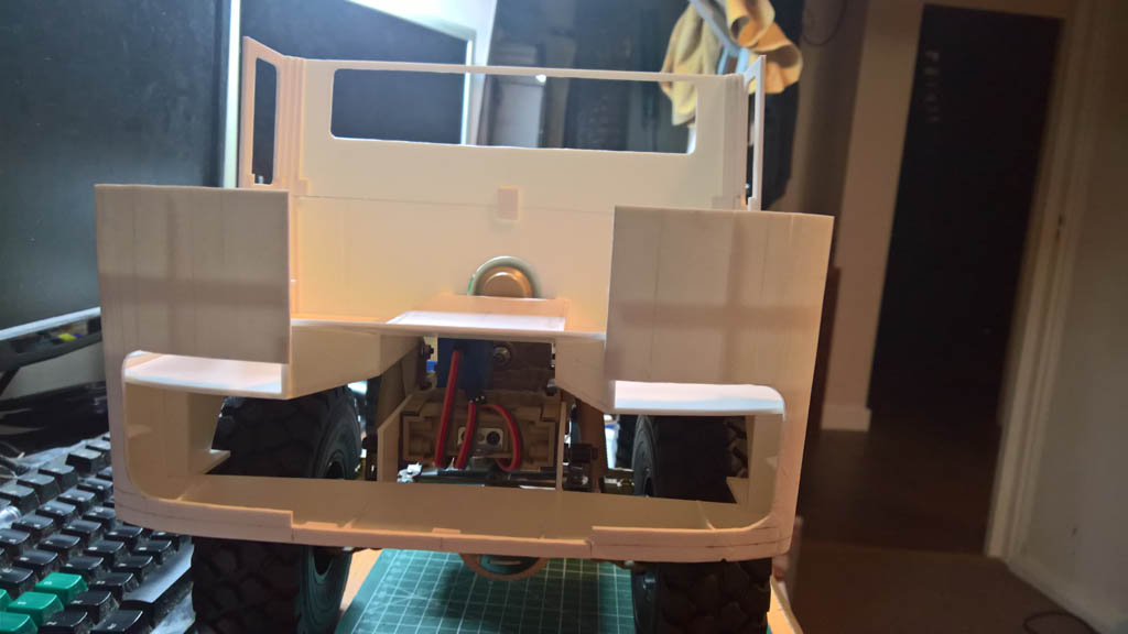

Got the bumper shaped up.

Thanks! The body panels are 2mm thick. The remaining parts are a mix of 2mm, 1mm and 0.75mm, depending on what I'm making. The curvy part at the front, for instance, has two layers of styrene - the first is 0.75mm, and the second 1mm. That's because just one layer would make the ribs show through - the second layer gives it a smooth look.

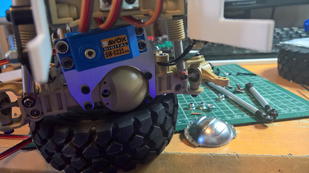

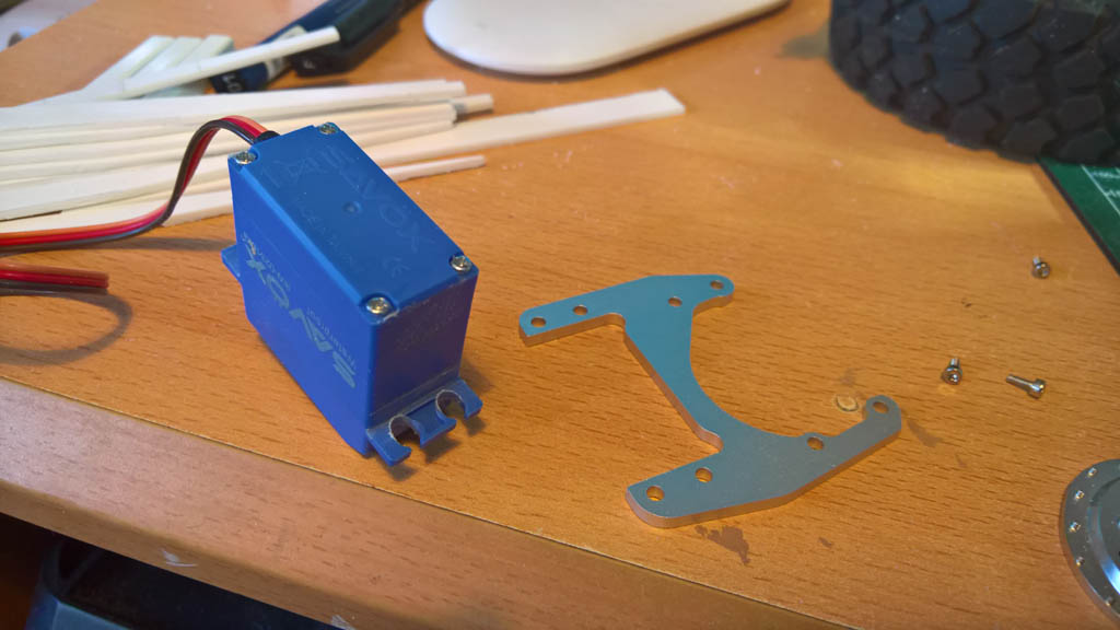

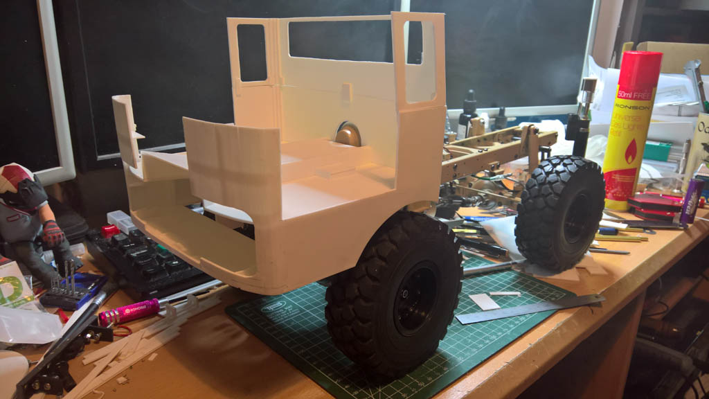

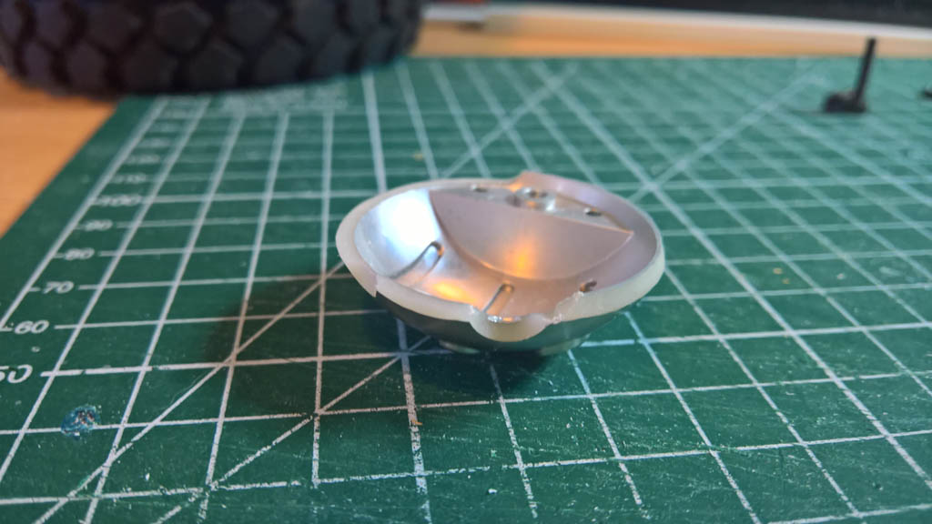

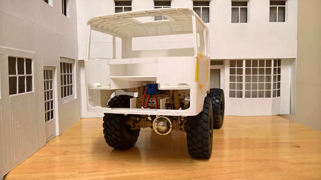

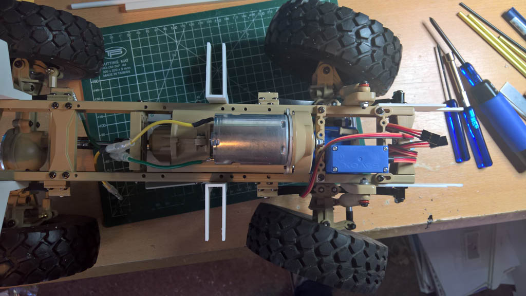

On to today's progress - transplanted the steering servo to the front to make way for the bed. Did this using the JunFac front steering kit for Tamiya High-Left axles (J44221). What I thought was going to be a 15 minute job turned out taking almost two hours. First, JunFac (GMade, really) assume all servos are equal. Seems some are more equal than others - mine needed belitteling at the waist, and embiggening in the screw holes.
Next, once fitted that servo mount gets in the way of the diff cover which, while gaudy, does serve to cover the hole through which the differential is locked and unlocked. In fairness JunFac call this out on their product page.
I don't want to disassemble and clean the axle after every run through water, so I had to do some remodelling:

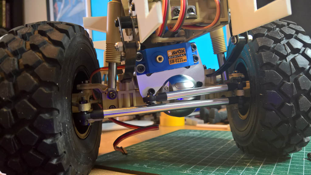

So far so good, and no train smash. The train smash happened once I had it all assembled. Notice how close the steering servo is to the shift servo's arm? There's zero space left for vertical axle travel, and I'll probably have to stick a bump stop in there to keep it clear.
Adding insult to injury, with the diff cover in place steering is even more rubbisher than it was without. And stock Tamiya steering sucks monumentally enough without the help. The obvious fix is to get rid of the dish part of the diff housing cover, and simply leave the tab that covers the hole. That aesthetic is going to be an eyesore, so I'm better off just making a new track rod.
So pretty disappointed by the whole experience. Leaving it there until I think of something better though - I can at least get on with the body.

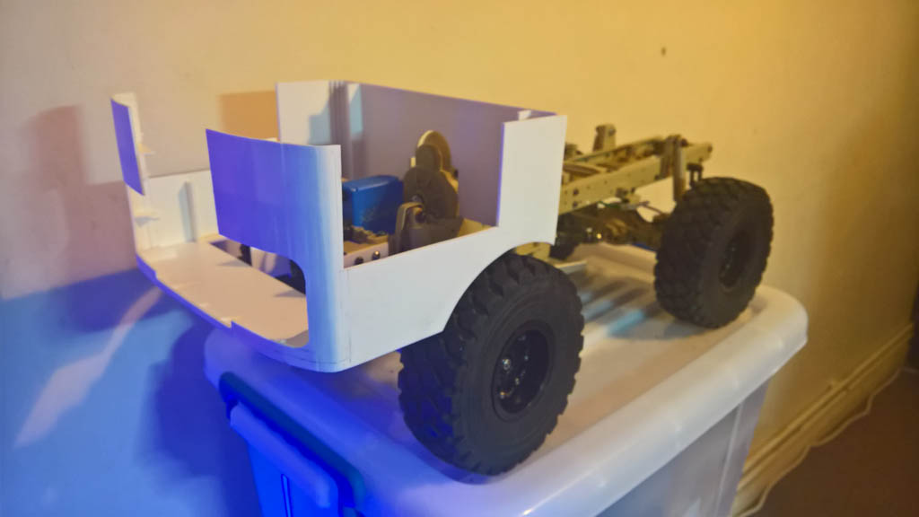

Lots of big steps coming so rather than get started I played with ride height last night. Because I know what this thing is going to be now.
And some comparisons -
I think it will end up between what's in the photos and what it was before. It's going to be a bush freighter in Mozambique so it needs to sit higher than an exclusively road-going truck, but not so high that it makes similarly-scaled trucks look small (as happens with the Bronco in the photo).

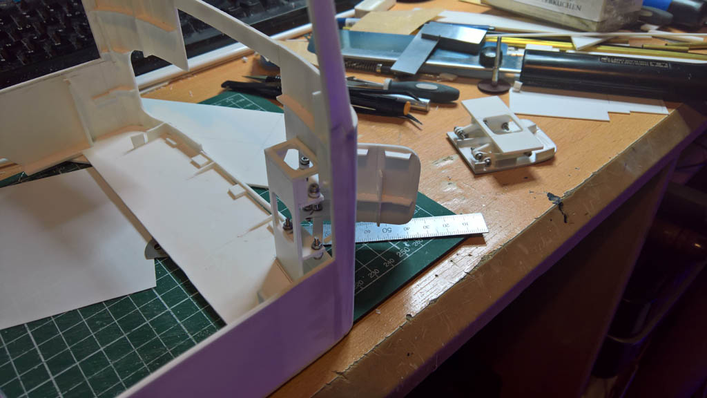

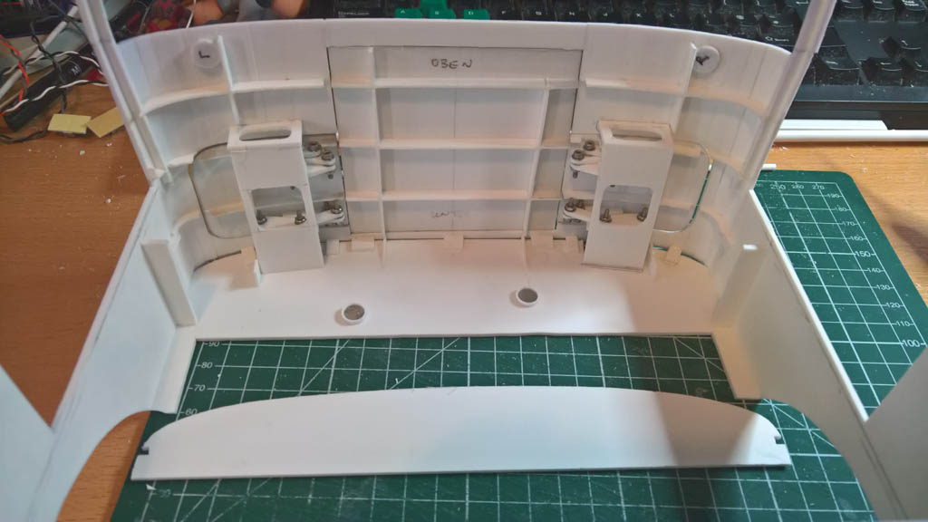

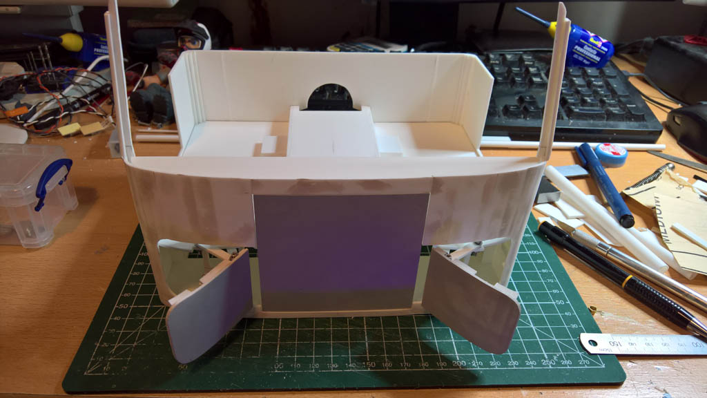

The sides of the grill are officially back in. Need to see how much space I have for a latch for the main piece, so stuck the makings of a dashboard in there with magnets.
Here it is from the front. Needs sills, so they don't close further than the body.
And open.
Windscreen is going to be interesting. I have 0.75mm clear perspex, but I doubt it'll hold the curve. Need to do some research...
