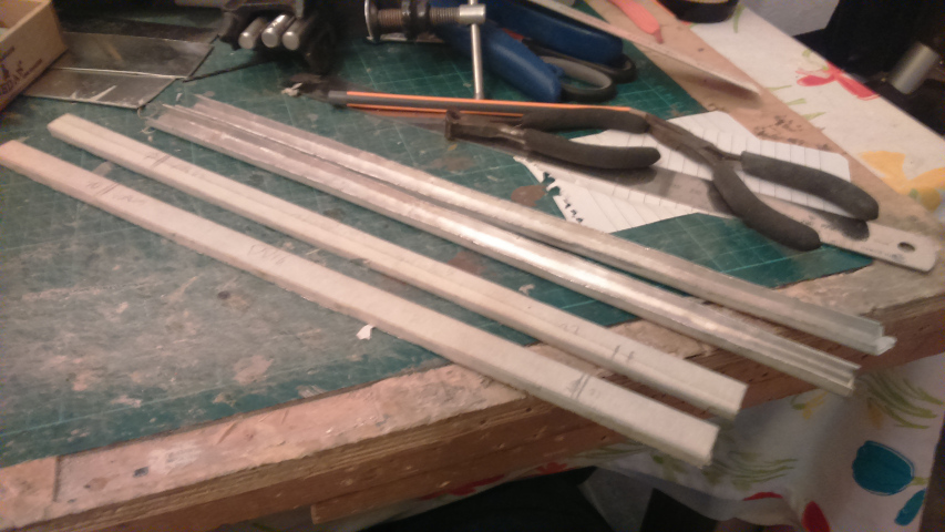

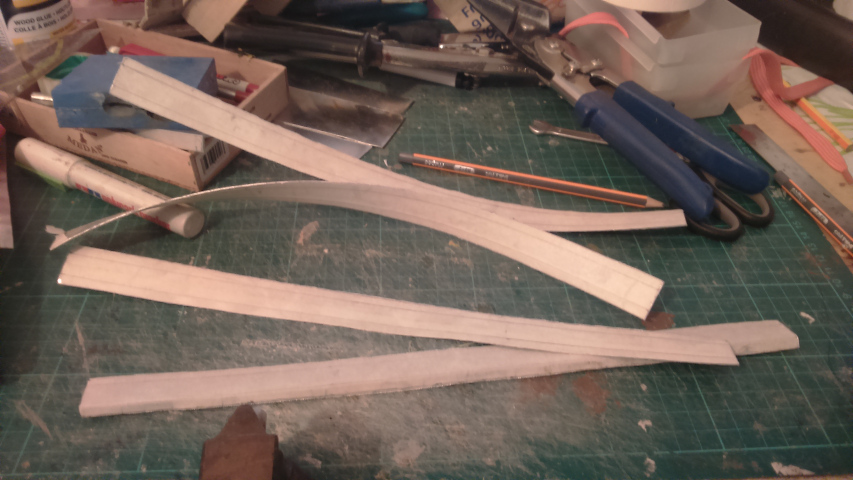

but I just can't do nothing.
framerails to be.
rails bend
mookup 4x4
torpedo mookup
here I just may have it cut a little short. but nothing that can't be fixed.

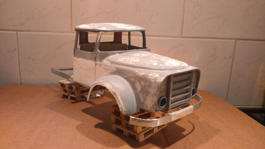

just a little update. I decided on builing a cab to sell. and buy the parts I can't build.
so just dividing my time on the projects at hand.

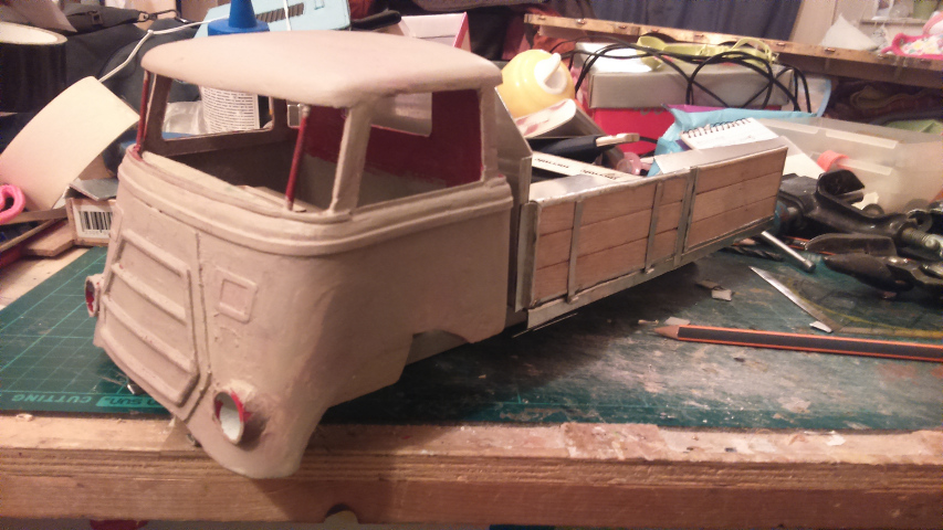

I have the torpedo chassis at the right lenght. and the sparewheelmounth on.

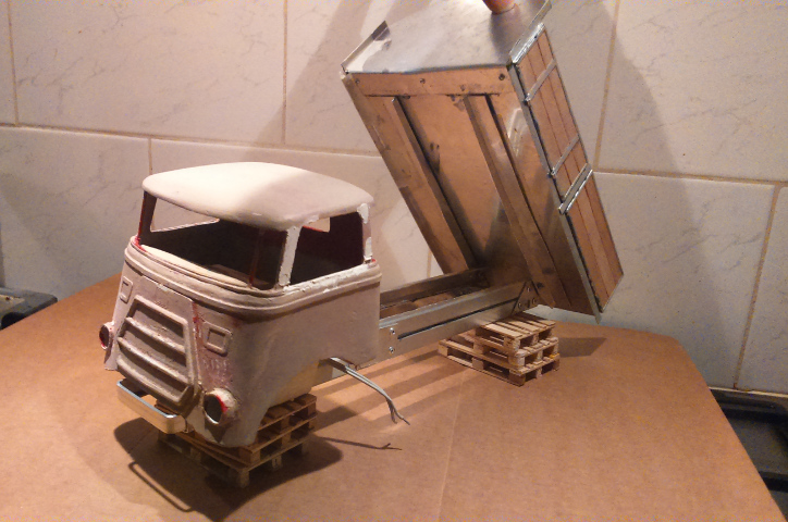

the 4x4 had a little work in the tipperbox.
the mechanics will be insired on the carson tipper system. with the motor for the system under the cab, and the drive motor will be mounted between the chassis. like the original asiatam chassis. there will not be a problem there
the frame rail of the tipperbody is just put on there with double sided stickytape. it needs some adjustment

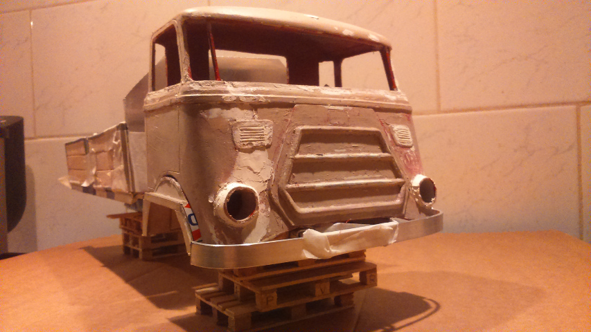

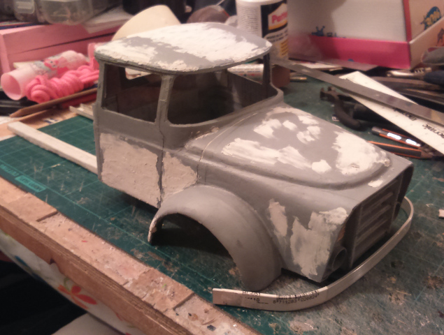

hi. getting it smooth is not that hard. the way I treat my models. is like it are real trucks.
the stuff I use comes form the carparts store not the modelstore.
an other thing is the line between putty and metal wood or plastic will show. the simpelest way to prevent that is to cover it all with putty. and have "the line" on a spot where it's oke to have a "line".
I have multiple layers of primer, filler, putty and sprayputty. if you want a brand. Motip paint and primer, and Alabastine carputty and sprayputty

the resin is a 1 component. the setting time is a few ours in the "cold and dark" and about half an our on a warm sunny day. I usually apply it last thing in the evening. and next morning it's set. to make it compleet
the putty I use takes about 10 to 15 minutes to be hard enough to sand.
the sprayputty takes about 5 to 10 minutes to set.
at this stage I use 180 grain dry sandpaper. just befor the colorpaint. I use wet sandpaper 280 of 400grain.
just as importand. let the sandpaper do the job. don't push to hard.
and this is for the torpedo.
the 4x4. I'm going to experiment with it. so failure is an option. it will get acrilic paint, form a tube. and I'll brush it on. It will also get some 2 component rush in some places. this way it's easiers to weather the truck.

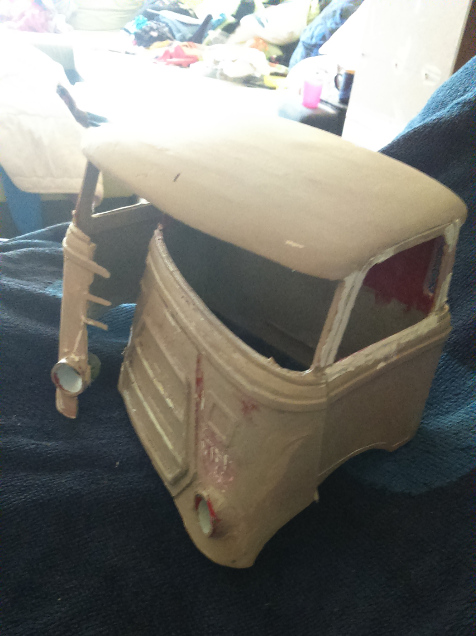

with a predictable end result. the dogs still chaise the cat. and the 4x4 droped of the table.
it looks bad. but this is a cab originaly build to be a positive mold. not to be the cab on the truck. and it had a few weak spots I just didn't know to find out this way.

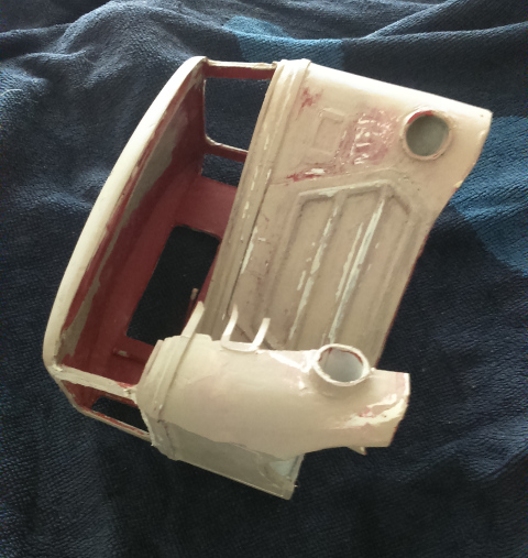

it's glued back in place, and I took some time to think if I was going to use the accidend to wheater the truck and put some rust around the crack, or make it smooth with putty.
yesterday I made it smooth. and I'll weather it in the spots I want

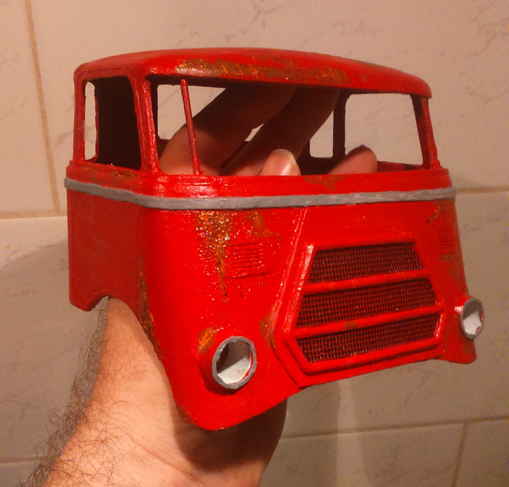

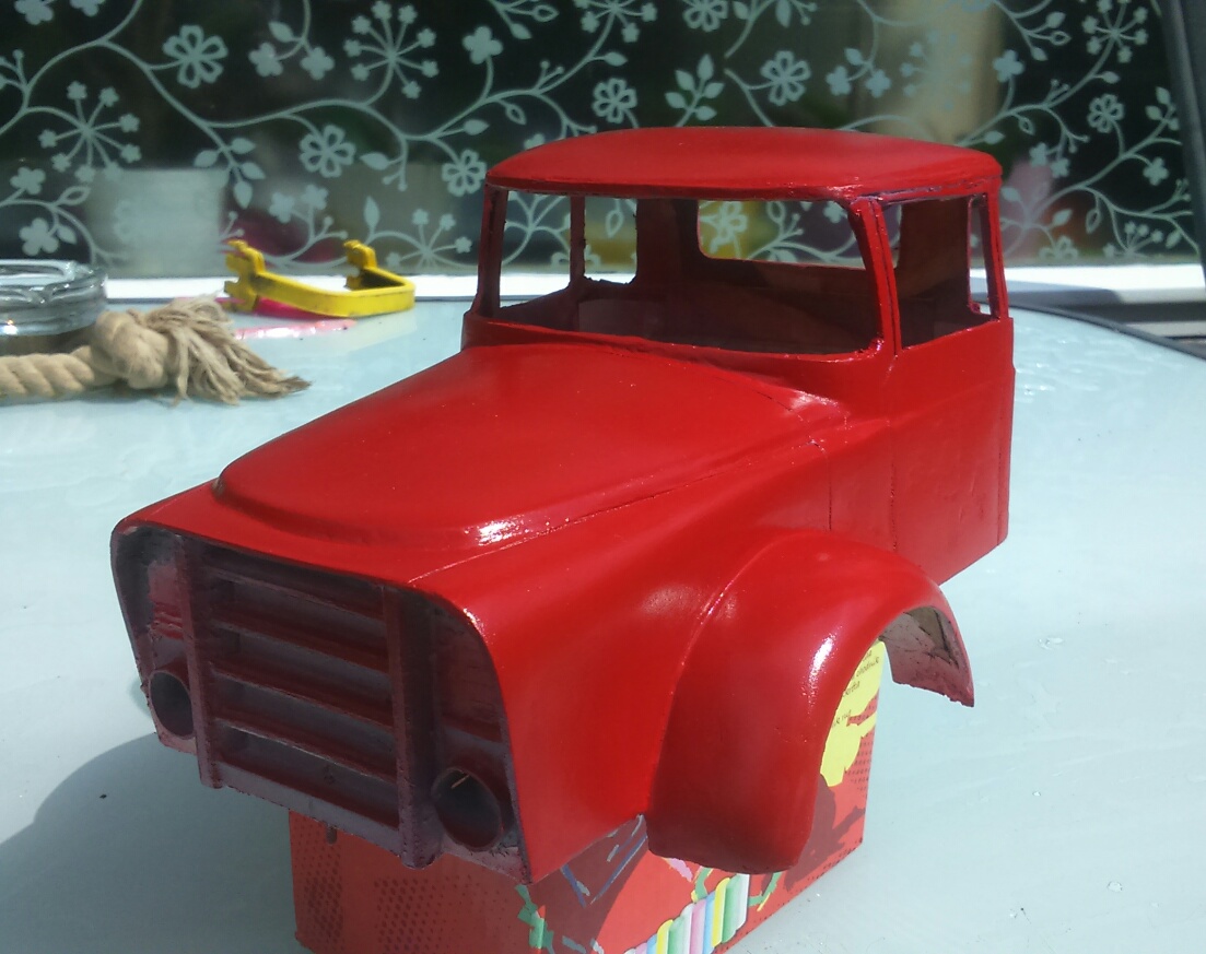

A little color on the torpedo

You do some really nice work, amasing what you can make out of cardboard.

Cardboard works so much easier than plastic. Just bending without heating it

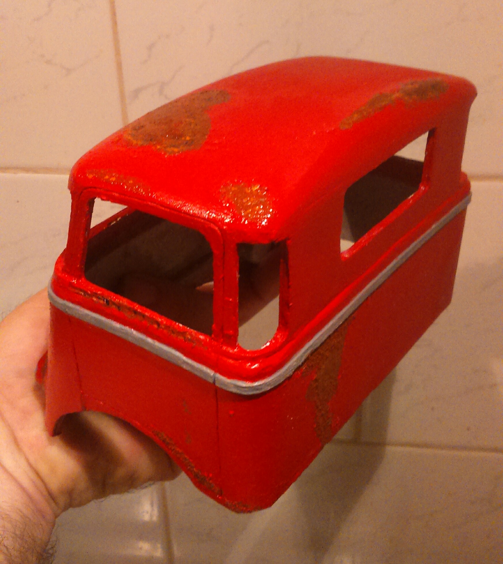

Sanding the basic shape is just a minutes work. And after the quick and easy build fixate is all with the resin. Well basecally the same way Formula 1 cars are build. I just use cardboard instead of carbon. And my resin doesn't need to go into an autoclave ;-)
The crashed cab just got some rust
The salt technique doesn't work without the airbrush. Luckely rust comes in more shapes than one
